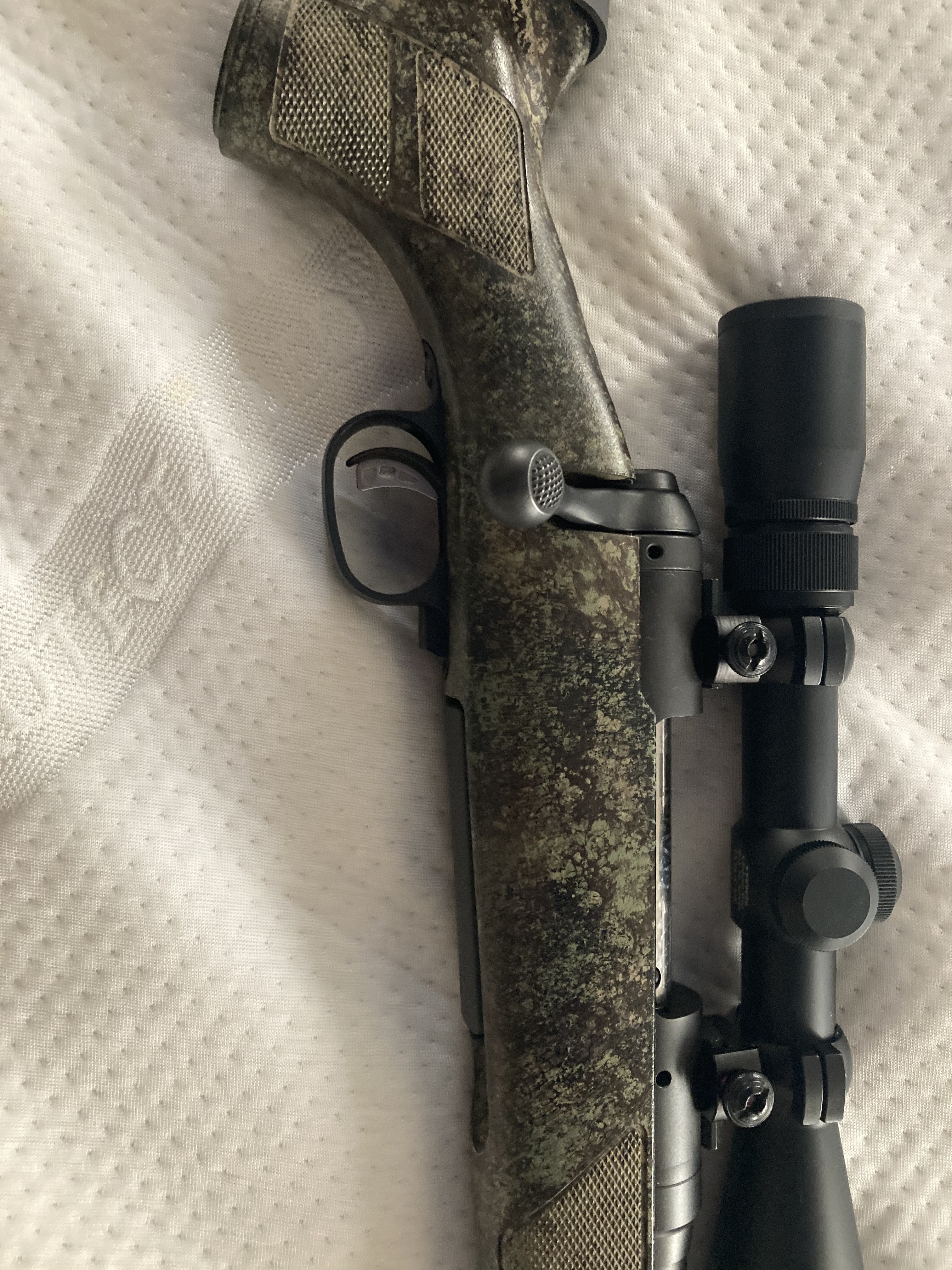

Dirty Dan Dawkins Posted July 6, 2023 Posted July 6, 2023 I did one with cheap Krylon or Rustoleum spray enamel satin finish I thinks You don’t need to do anything fancy or buy anything special. After this, I personally see no benefit in the added time or cost of space aged wizardry and chemicals on a stock worth $50-$100. Savage 110 260 Remington We did redneck digital camo. I lightly rubbed it with a scotch brite pad ( light enough not to look like sand paper was drug across). Cleaned it with plain rubbing alcohol. You don’t need special cleaners. Primed it with gray. I also bought black, green, brown and tan paint, then with paper plates used as a palettes, sponge painted it with a kitchen sponge starting with tan and working through the darker shades to finally black. You can do the reverse or just random through colors, but if you wish for it to be uniform do one color at a time. If you mess up or don’t like it, just go back over it again. It’s a cheap stock of irrelevant value. This process results in several layers, and has held up well. Satin clear coat it, if you like, for an added layer of wear-through protection. But if you just want solid colors, I’d just prime it and put on 2-3 good coats and maybe a clear coat and call it a day. The only purpose this serves is to defeat the monotony of a plain black stock.
