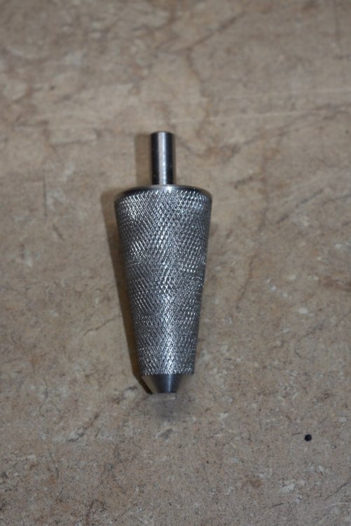

Philosopher Posted October 7, 2022 Posted October 7, 2022 If you don't reload shotgun shells now's the time to start. I reload 2 5/8" 12 gauge shells for my Winchester 97 Black Diamond model. I shorten the hulls to 2 5/8" using a dowel rod that has an Exacto blade set in a tranversely drilled hole, with a wood screw in the end to adjust cutting depth. I then crimp the shell over an overshot card (Harten crimp) so that I don't have to roll crimp.
PAdogman Posted October 7, 2022 Posted October 7, 2022 @Philosopher, I'd love to see a pic of that cutting jig. I've used a dowel and utility knife on .410, but the method I used could certainly be improved upon.

Philosopher Posted October 7, 2022 Posted October 7, 2022 Here's the shell trimmer I constructed. Saw this on the internet decades ago. I've used this technique to load 2 1/2" 20 gauge shells, 2 9/16" 16 gauge shells, and 2 5/8" 12 gauge shells. The dowel rod is 5/8" diameter, works for trimming hulls from 20 gauge through 12 gauge. The hole that holds the Exacto blade is about 3/16" in diameter, and is 2 1/8" from the end of the dowel. Tap the Exacto blade through the hole at a 30 degree angle with the sharp edge angled down. On the end of the dowel is a round-headed wood screw that is backed out or tightened to adjust cutting depth. I put a couple washers under the screw to keep it from shifting in use. My finished, loaded shells are the SAME overall length as a factory shell, and the crimp is folded at the same point. The opened length of a fired hull is 2 5/8". Since the hull has been shortened the end of the shell is open at the center of the crimp, so I use an overshot card to keep the pellets from dribbling out. I believe this is referred to as a Harten crimp. I use a 5/8" paper punch I found on Amazon to make my own 12 gauge over shot cards out of light weight cardboard (cereal boxes). To load these short shells I do not have to change the adjustments on my press MEC 700 press from how its set when loading 2 3/4" shells, and I crimp as usual after placing the over shot card in place. I can load these shells at just a slightly slower speed than uncut shells using the same powder charges and wad as I use for 2 3/4" shells. Roll crimping not required, nor is skiving the end of a cut hull. If you're making short shells out of plastic hulls any other way you're doing it WRONG.
