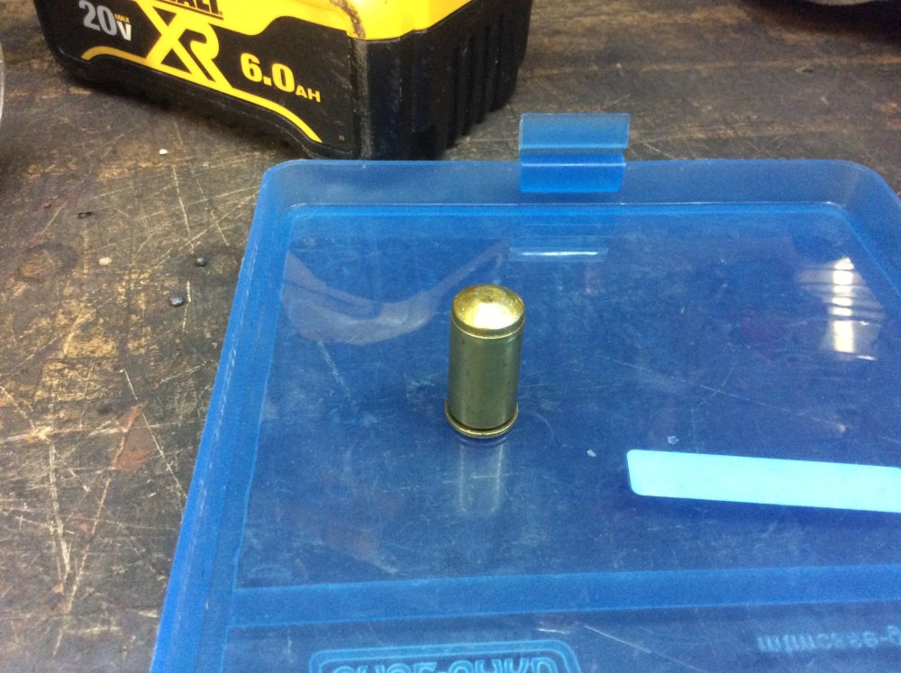

PanioloPete Posted January 30, 2022 Author Posted January 30, 2022 On 1/18/2022 at 11:26 AM, Springfield Slim SASS #24733 said: All this talk of freebore always makes me laugh. For years people who wanted accurate target guns loaded 38 special brass in a .357 gun, and used a big flat ended bullet seated flush with the end of the brass, that would contribute nothing to centering itself in the forcing cone of a barrel. And it worked fine. And here we worry about being able to hit an 18" plate at 20 feet or less. True enough! I started thinking about that when I was reorganizing my bullet and case storage. Heck, I’ve been shooting .38 Specials outta my .357 revolvers for years without a problem or second thought!
