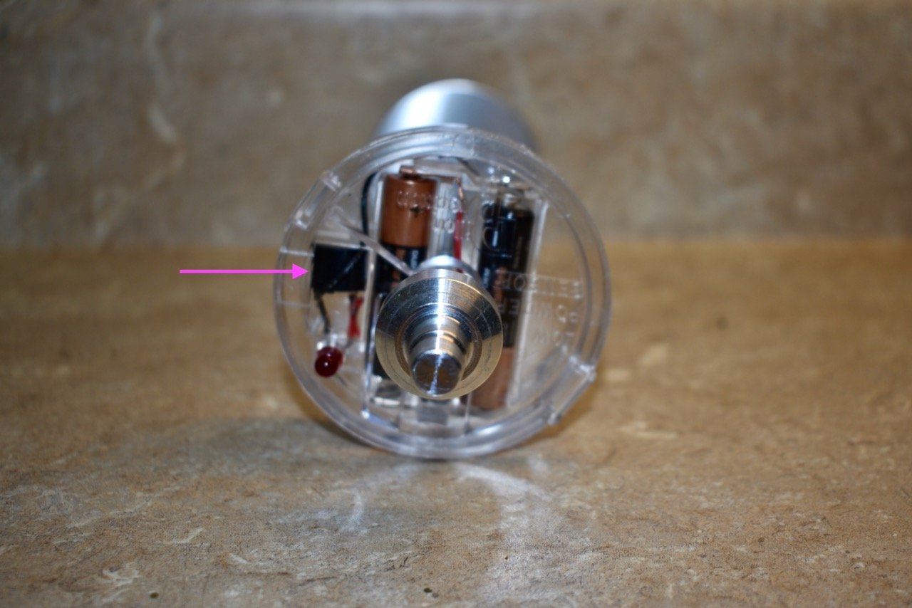

Tequila Shooter Posted November 3, 2021 Posted November 3, 2021 For those looking to change out what they have or add a powder check, here is another option. The DAA Magnetic Powder Check 2.0 is activated off the top rim of the case rather than the base of the shell plate, this means that no alarm will sound if no case is present. The powder sensing plunger (now with brass shoe) enters into the case mouth to rest on top of the charge and measure its height, sounding an alarm if the powder level is either too low or too high. It provides both an audible beep alarm as well as a bright red LED light when triggered. The DAA Magnetic Powder Check 2.0 includes a replacement short plunger, suitable for use with rifle ammo. When using for rifle, simply replace the plunger, and assemble the steel rod upside down, using the end without the brass shoe to enter into the small case mouth. Parts included make this suitable to use with all pistol ammo (9mm and up) and for rifle from .223 and larger. DAA Powder Check
