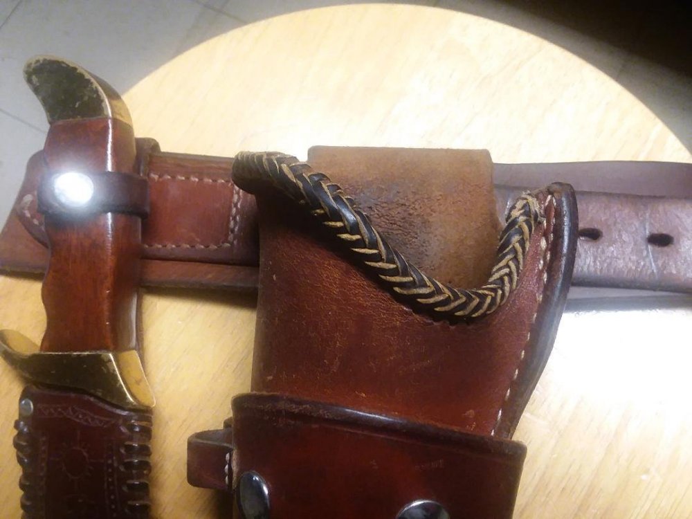

Attica Jack #23953 Posted February 5, 2020 Posted February 5, 2020 Here is a photo of my holster, that I rolled out the lip and put some braid on the edge. My setup is over 30 years old and it is a unlined inexpensive Triple K rig, still use it today.
Marshal Hangtree Posted February 5, 2020 Posted February 5, 2020 2 hours ago, J. Mark Flint #31954 LIFE said: There is, it is just not me. And J. Mark is ahead of me, way ahead.
Marshal Hangtree Posted February 5, 2020 Posted February 5, 2020 1 hour ago, Attica Jack #23953 said: Here is a photo of my holster, that I rolled out the lip and put some braid on the edge. My setup is over 30 years old and it is a unlined inexpensive Triple K rig, still use it today. Really nice job, Attica Jack!
Cat Brules Posted February 5, 2020 Posted February 5, 2020 7 minutes ago, Marshal Hangtree said: Really nice job, Attica Jack! Yes, I like it too, AJ. It looks functional and is very unique. Cat Brules
