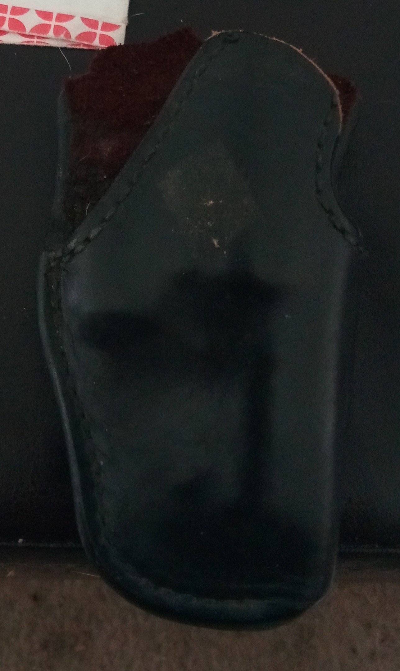

Alpo Posted September 9, 2019 Posted September 9, 2019 I want to put a holster inside a pocket. It seems like the best way would be to put velcro inside the pocket, and on the back of the holster. Put it where it needs to go and push. This way when the vest is dirty I can remove the leather holster before laundering it. About there in that big patch pocket. I plan to cut both the paddle (which I have bent straight in the picture) and the thumbsnap off, leaving a plain pouch/pocket for the pistol to sit in. Velcro, as I'm sure everyone knows, is plastic hooks on one piece and cloth fuzzies on the other. Would it be better - a stronger bond, maybe - to have the plastic hooks in the pocket and the fuzzy on the holster, or the other way round?

Alpo Posted October 21, 2019 Author Posted October 21, 2019 Way-ull. Finally got it done, and it don't work. Trimmed the extraneous off the holster. Put the hooks on the backside (the hooks on that heavy duty stuff looks completely different than the hooks on the regular stuff). Put the fuzzy stuff inside the pocket on the side up against me. The problem is that the vest itself is so thin. While the velcro held the holster fine, the vest material would not support the holstered revolver. It just - leeeaaaaned over. Still stuck to the vest, but now horizontal to the floor, instead of vertical. Ah weeeeel. The best laid schemes o' mice an' men, gang aft a-gley
