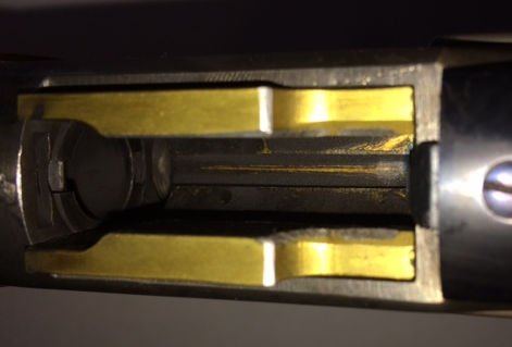

Chicken George* Posted January 29, 2019 Posted January 29, 2019 I'm having an ejection problem on our 1873. Gun works fine until you go at a decent speed and then the empties seem to be getting caught with the rim behind the carrier. Seems to be every 2 or 3 shots when lever fast. I recently upgraded to an aluminum carrier and it seemed to shoot fine but we didn't shoot it too much before the mainspring broke. After replacing that we noticed the problem. The timing looks perfect to me. As the next round comes up, the rim barely kisses the lower bolt tab. I don't know how the mainspring could affect it but I tried adjusting that differently with no difference. Not sure where to go from here. I don't want to send it in because we are are trying to prep for WR. Update: I forgot to mention that the ejector and bolt tab look good. I pulled them off, cleaned and adjusted them and put them back on and that didn't help.
Snake-eye, SASS#45097 Posted January 29, 2019 Posted January 29, 2019 Cut a small bevel on the carrier were the case is touching in your pictures. This will help the case slide off. Very little goes a long way.
Blast Masterson Posted January 29, 2019 Posted January 29, 2019 Your problem is the carrier you replaced. It is thicker and begins to move sooner than the old one. The bolt 'kicks' out the case as it recesses into the receiver. Your carrier gets up there before this happens. You can take something off the top, or you can correct it from below. I prefer the latter as that is where the timing issue is occurring first. This may prevent other issues from happening. The lifter arm can be modified, but I would adjust the Alu Carrier as you have a replacement (the original) if you mess it up.

J-BAR #18287 Posted January 29, 2019 Posted January 29, 2019 I agree with Snake-Eye. Here is an aluminum carrier in one of my ‘73s. Bevel the area in contact with the case rim at the rear of the carrier. You need to give the rim room enough to rotate and slip out from under the extractor. Don’t go crazy, remove a bit and test frequently.

Garrison Joe, SASS #60708 Posted January 29, 2019 Posted January 29, 2019 As above, the reason you are having problems is that the new carrier is not beveled at the rear shelf top surface, so as to allow the rim to twist upward and out. Compare your old carrier to the new one, bevel about the same. Here's photos of a couple of carriers in my 73 .45 Colt guns:: Notice I filed a little extra bevel on the second carrier to ensure clean ejection (first aluminum carrier came from Pioneer Gunworks, second from Cowboys and Indian shop). BTW - The EXTRACTOR is what has the hook over the top of the rim. Your post mentions the "ejector" looking good. You are talking about the extractor. The "ejector" on a 73 is the back edge of the top shelf of the carrier! Good luck, GJ

Chicken George* Posted January 30, 2019 Author Posted January 30, 2019 I really appreciate all the responses! I had actually thought that filing the carrier would work but was nervous to do so. I appreciate having pictures to go by. My new carrier is from Cowboys and Indians, which is the one Garrison Joe said that he had to modify. So that must be the one that needs this mod. I didn't get a chance to do anything yet and will post after I do.
Chicken George* Posted February 2, 2019 Author Posted February 2, 2019 Thanks guys!! Worked like a charm! Got it fixed last night and we shot it a lot today without a hiccup. I actually had to take off a lot more than I thought. But with that bevel cut and a slight adjustment to the timing, it is running better than ever. Thanks again!! CG
