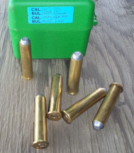

Three Foot Johnson Posted November 8, 2014 Posted November 8, 2014 J-Bar, the 405 gr takes a charge of 50 and up, 40 is way too light It has proven to be a very accurate Plainsman load out to 100+ yards in an original Trapdoor, and three H&R's. Why would it be way too light? I've experimented with this bullet in a .45 Colt case, and even less powder with good results, other than it's too long to feed through the action of the '92 I was working with.
