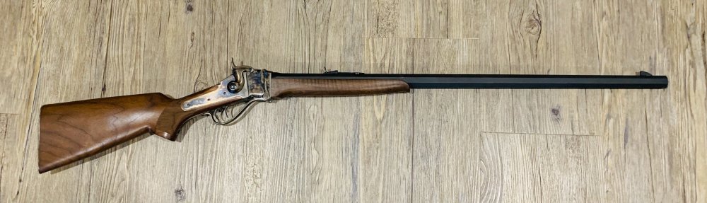

Mysterious Stranger Posted May 16, 2023 Posted May 16, 2023 I managed to buy my Pedersoli Sharps yesterday, and even got a really good deal on it: It's the Pedersoli Sharps "Hunter" model, which is the now discontinued lowest priced Pedersoli Sharps model, that has none of the fancier features of some of the more costly models. In the U.S., it is still available at a price of about $1900, but it recently disappeared from the Pedersoli website. In Canada, these are pretty rare. But Cabela's Canada in Calgary, about 220km = 136 miles from where I live, had ONE in actual inventory, but they actually needed to verify that it was actually at that store before I could buy it. I really did not want to spend a lot of money on another rifle right now, but I had one lever rifle whose condition a selling dealer had misrepresented to me that I did not want to keep, and my wife encouraged me to jump on this Pedersoli because if its anomalous Cabela's Canadian price. In The U.S., Cabela's advertises this model at the regular U.S. price of $1900, which is about $2600 Canadian at the current currency exchange rate. But for some reason, here in Canada, Pedersoli rifles are sold at about that same amount, or lower, paid in Canadian, not U.S. dollars, despite the fact that the Canadian dollar = only $0.74 US. That makes these Pedersol rifles a REAL bargain. This specific rifle model in fact has been advertised on Cabela's Canadian website at $1780 Canadian, which is about 1/3 less than in The U.S., for at least the few weeks that I have been looking at Pedersoli Sharps rifles, and incredibly, no one else has bought it! So, I drove up to Calgary, traded in a lever rifle I did not want to keep, and got back into Cowboy Action long range side match shooting at the lowest possible cost! The Pedersoli Sharps models are apparently not as finely finished as the U.S. made "Shiloh" and "C-Sharps" models, but the prices for those are in the "several thousands" category even in The U.S., and so importing one into Canada would be, for me, ridiculously unaffordable as a retiree. The Pedersoli rifles, which are made in Italy, have an awesome reputation among knowledgeable shooters that like to shoot "Old West Buffalo rifles". They are very high quality, machined from forged metal, with "progressive" broached rifling that becomes a thou or two smaller in diameter from the breech to the muzzle, apparently to facilitate use of the largest diameter bullets to improve bullet sealing in the rifling and avoid leading. All the models come with the typical rifle blade front sights and barrel mounted rear leaf sights with elevator ramps, but ALL models are drilled and tapped to accept multiple brands and sizes of "Creedmoor" vernier peep ladder sights and front tunnel sights with interchangeable inserts, for those 500 to 1000 yard shots these rifles are capable of making. I had a different Pedersoli - a Rolling Block" model - a couple of decades ago, and at a national SASS match in Cody Wyoming, I successfully shot a full-size steel buffalo profile at 500 yards = 1500 feet with a good set of sights on it. It was a treat calculating the required rear sight setting, aligning the sight picture, taking the shots, and waiting about a full second for the 1350 fps muzzle velocity 405g bullet to reach and "clang" the target, and then waiting another second or more for the "clang" sound to be transmitted back to me! (Sound travels at only about 1100 fps). So, this "Plain Jane" model can be equipped with aftermarket items to perform just as well as the prettier much more costly models ($3000 US or so). So I have a great foundation to build on. I will be looking for a good deal on new or used MVA or Shaver or other highest quality rear sight and front tunnel kits. And this Sharps Hunter model has a couple of specific features I particularly like: a pistol grip stock, a 30" barrel, a hefty weight of 10.5 lb before adding the aftermarket sights, a full octagon barrel, and a "Shotgun" butt plate instead of the more typical "concave curved" butt plate (I find the shotgun butt plate much more comfortable when firing some of the heavier loads). And the dual set trigger has an amazingly low trigger pull and is very crisp. This is a rifle I will not be foolish enough to sell or trade off.
Eyesa Horg Posted May 16, 2023 Posted May 16, 2023 Very nice!! Sounds like you got a great deal as well. Congrats, it will be a fun rifle!
irish ike, SASS #43615 Posted May 16, 2023 Posted May 16, 2023 The reality of these rifles is that Shiloh and C-Sharps may have a better fit and finish. The barrels are what make a rifle a shooter. Pedersoli now shows up at many BPCR matches and does well. I've shot a Billy Dixon for years and it out shoots me.
Silver Creek Jack Posted May 16, 2023 Posted May 16, 2023 I have owned and shot pedersoli sharps rifles for many years and have never been disappointed with their accuracy or appearance, great rifles from a great company!
Tex Jones, SASS 2263 Posted May 16, 2023 Posted May 16, 2023 1 hour ago, Silver Creek Jack said: I have owner and shot pedersoli sharps rifles for many years and have never been disappointed with their accuracy or appearance, great rifles from a great company! Me too.
watab kid Posted May 16, 2023 Posted May 16, 2023 nice looking rifle - congrats , i think you will like it a lot , be picky about your upgrades , i wasnt on my rear sight and will be reinvesting down the road a little , i hate spending money twice but i wasnt picky enough with mine ,
