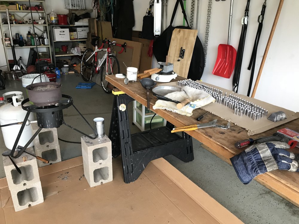

  6. I do it in open garage. Turkey fryer. Mold oven, typically I get one reject, -2 gr. Lots of room.
