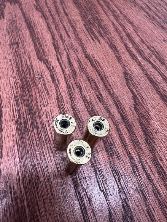

vidette Posted March 19, 2023 Posted March 19, 2023 In the last few months I’ve been noticing this crop up 3-4 rounds out of 100: looks like the head of the primer blew clean off the primer casing and left the case in the pocket. These shells are now ruined and of course cause a new primer to get crushed in my machine if they make it onto the press any ideas what causes this? My load data and all the ammo components have not changed in years. I’m using relatively new (7-10 times fired) starline brass, 3.1 titegroup, federal 100s, 105gr coated bullets. im wondering if the quality of federal primers has taken a dive?

Jim Brown Posted March 19, 2023 Posted March 19, 2023 Are you finding them after resizing and depriming. If so the decapping pin may be punching our the center. I have not seen in 38 however, I have had the happen loading 223. - Mostly once fired with crimped primers, but I have had some after a couple of reloads. Jim
vidette Posted March 19, 2023 Author Posted March 19, 2023 10 minutes ago, Jim Brown said: Are you finding them after resizing and depriming. If so the decapping pin may be punching our the center. I have not seen in 38 however, I have had the happen loading 223. - Mostly once fired with crimped primers, but I have had some after a couple of reloads. Jim I’m noticing this after depriming but honestly I haven’t been inspecting all primer pockets before tossing the brass in the casefeeder so I’m not 100% sure. If it is the depriming pin, that makes sense but I wonder why it just started happening. I’ll pull it out and give it a good cleaning.
Captain Bill Burt Posted March 19, 2023 Posted March 19, 2023 I’ve had gravel get into a case and bend a depriming pin.
Sedalia Dave Posted March 19, 2023 Posted March 19, 2023 What brand of primer are you using? How are you cleaning your cases? I have seen this before in 38 special cases. What is happening is corrosion is occurring between the primer and the primer pocket. This usually occurs when you fail to ensure wet brass is completely dry before storage.
Jim Brown Posted March 19, 2023 Posted March 19, 2023 11 minutes ago, Sedalia Dave said: What brand of primer are you using? How are you cleaning your cases? I have seen this before in 38 special cases. What is happening is corrosion is occurring between the primer and the primer pocket. This usually occurs when you fail to ensure wet brass is completely dry before storage. I was going to give this response. Wet case and corrosion- This is primarily what I have seen in 223 that has been previously reloaded (crimp removed). The decap pin is fine- problem is primer to case Jim
vidette Posted March 19, 2023 Author Posted March 19, 2023 Ah, good catch. I use wet tumbling and typically let the cases air dry for 3-4 days. I’ve never had a problem but maybe winter months are different.
The Original Lumpy Gritz Posted March 19, 2023 Posted March 19, 2023 3 hours ago, vidette said: Ah, good catch. I use wet tumbling and typically let the cases air dry for 3-4 days. I’ve never had a problem but maybe winter months are different. Deprime before wet tumbling. Dry on a towel, with a fan to help.
Marshal Fire, SASS 10064 Posted March 19, 2023 Posted March 19, 2023 I experienced the same issue. Wet tumble the brass and allow several days to air dry. Primers would stick in the primer pocket and the pin would knock the bottom out of the primer. Also had a few rounds fail for work. Invested in a case dryer, looks like a food dehydrator. Works very well and in a few hours cases are dry. you would be very surprised how long moisture can remain in the bottom of a shell case.
Garrison Joe, SASS #60708 Posted March 19, 2023 Posted March 19, 2023 Don't use strong acids in the wet tumbling solution. That accelerates any corrosion between the primer and the case head. Sulfamic acid in Lemishine is a commonly used tumbling additive, that is a weak acid. Vinegar is a weak acid, but also corrodes brass. If you use those or other acids, be SURE to limit time cases spend in solution to about 15 minutes, and thoroughly rinse the tumbling solution off with clean water. In the winter, lower air temperatures increase the time for cases to dry after wet tumbling. I'd consider warm-drying the cases, as noted above. good luck, GJ
