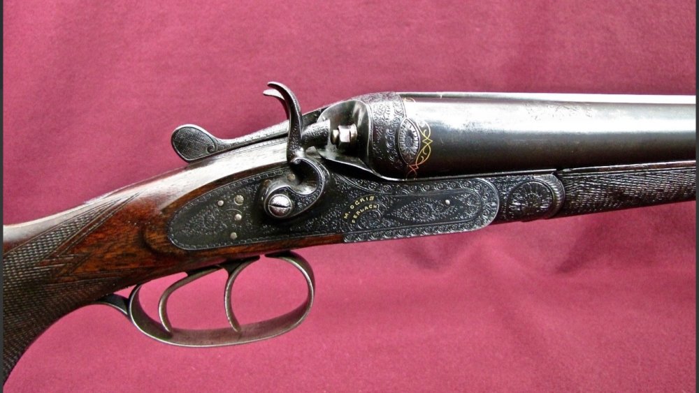

Wolfman0125 Posted November 10, 2022 Share Posted November 10, 2022 (edited) Just acquired an Austrian made hammer gun from 1910. It has 2 5/8” chambers. Is there any information available about reloading for this? It does not have a Damascus barrel. It is my first Hammer gun and I’m new to reloading and SASS though I’ve got an extensive collection of Cowboy rifles and revolvers and black powder revolvers. I’d appreciate any tips or help in getting started reloading as far as what basic equipment is needed to reload .45 Colt, 12 gauge and 44-40. Edited November 10, 2022 by Wolfman0125 5 Quote Link to comment Share on other sites More sharing options...

H. K. Uriah, SASS #74619 Posted November 10, 2022 Share Posted November 10, 2022 Either have the chambered lengthened to 2-3/4" or reload shorter shells. Simplest way to do the latter is just trim 2-3/4" to the desired shorter length, and put an overshot card in before you crimp. That's how I load 2-1/2". (Well, that and Magtech all brass.) The advantage of lengthening the chamber is that you can use/reload ordinary 2-3/4" shells. 1 Quote Link to comment Share on other sites More sharing options...
Garrison Joe, SASS #60708 Posted November 10, 2022 Share Posted November 10, 2022 As fabulous condition as that old gun is in, and certainly hard to get parts or a gunsmith willing to work on it, I would be real hesitant to use it for Cowboy matches. It will take quite a beating. Maybe use it for cowboy clays shooting, though. Aguila makes short smokeless 12 gauge ammo, as does B&P. Not all old guns have enough chamber wall thickness to be safely lengthened to 2 3/4" chambers. A gunsmith should check it first. I would not jump right into loading specialized shotgun shells as your first attempt in reloading. Learn on the easy stuff - metallic cartridge. Rifle and revolvers. good luck, GJ 3 Quote Link to comment Share on other sites More sharing options...
Sedalia Dave Posted November 10, 2022 Share Posted November 10, 2022 Beautiful shotgun. JMHO but I would not use it for CAS for the followinf reasons, First because of the short chambers. Second because it has a Greener Crossbolt lock. When you open the action the locking bolt protrudes from the left side of the action. The edges of this bolt are rather sharp and when reloading on the clock you stand a good chance of cutting yourself on these edges. Third is that fine English buttstock looks awfully thin in the wrist area. While this makes a beautiful gun, it is also a weak spot that will crack if abused. Ask the shooters using BSS shotguns how many cracked stocks they have seen or experienced themselves. When that stock cracks in the wrist area you'll pay more for a replacement than you did for the shotgun. Like Garrison Joe stated use it for Cowboy Clays or another side match where it will not get abused by dropping it on a prop as you transition between guns. Break it out when you are shooting for style points and not time. 1 Quote Link to comment Share on other sites More sharing options...

Chantry Posted November 11, 2022 Share Posted November 11, 2022 A very pretty and almost certainly a very well made shotgun. And I'll agree with what's been said above, don't use it for SASS. Even the most basic repair will cost money. I had to have two screws that hold the hammers on done to a Birmingham made British shotgun. It cost $300 to make the two new screws and have them engraved and antiqued to match the rest of the gun. If the gun has to be re-stocked, figure $5000 (labor) PLUS the cost of the wood to be used. And that's probably a low estimate. Quote Link to comment Share on other sites More sharing options...

Lassy LaRock Posted November 11, 2022 Share Posted November 11, 2022 Both barrels are marked "NICHT FÜR KUGEL" (NOT FOR BULLETS), which means that never bullets or slugs may be fired from this weapon. Quote Link to comment Share on other sites More sharing options...
