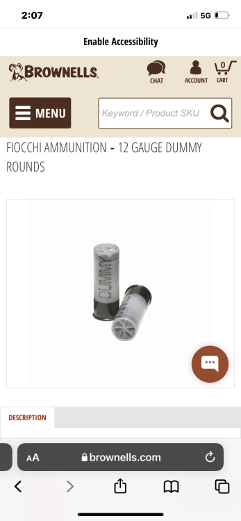

Sedalia Dave Posted March 28, 2022 Posted March 28, 2022 9 minutes ago, Irish-Pat said: Look at these from Brownell’s How do they compare in weight to an empty AA or STS hull? Practicing with a SXS using hulls that are heavier than empties will cause a shooter to develop poor shucking habits.
