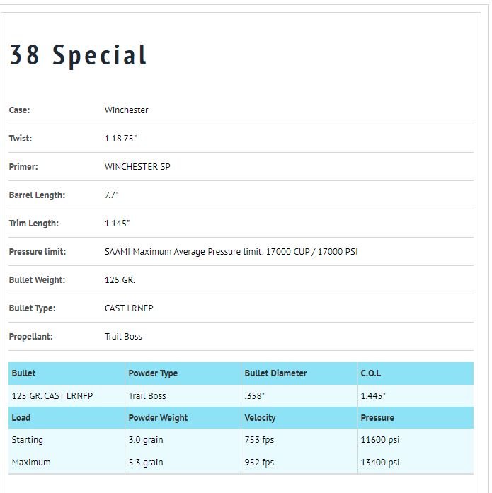

Buckshot Bear Posted January 23, 2022 Posted January 23, 2022 I need to change my powder from ADI AP50N as I'm getting really low as we've burnt through a helluva' lot and need to keep what I have of it left for loading 9mm. I have - Win231 but need to save that for .32 wadcutters ADI AS50N (jug) ADI AS30N (jug) ADI APS350N (jug) ADI Trailboss (jug) My current loading for .38's is ADI AP50N 3.4gn pushing a 125gn pill and its just a really nice load to shoot. My wife Jenorado, two sons and two daughter in laws all like it so I'd like to try and emulate it as close as possible with one of the above powders. Been able find this information on the ADI website and also below, the velocities that I'm getting with the current load out of my rifle - As always....I know I'm asking a LOT of questions continuously and I do really appreciate all the answers and advice that comes my way, thanks pards.
DeaconKC Posted January 23, 2022 Posted January 23, 2022 The only one I have used is Trail Boss. Works well, but does flow slowly through powder measures, so watch it closely.
Garrison Joe, SASS #60708 Posted January 23, 2022 Posted January 23, 2022 I never loaded to a power factor greater than 100 with a 125 grain bullet in .38 special. That would seem to be something like that 30N powder, using the starting load listed above, to make 800 FPS. Low recoil, accurate enough and powerful enough for most distances and most knockdowns. But YOU know the AS powders so much better than we do, so perhaps there would be something wrong with that suggestion. I just like a little bit of fast powder for Cowboy, rather than lots of slower powder. And, why start loadng Trail Boss now if it is going to become unavailable until 2023. You have 6 shooters to fill cases for, right? good luck, GJ

PowderRiverCowboy Posted January 23, 2022 Posted January 23, 2022 11 hours ago, DeaconKC said: The only one I have used is Trail Boss. Works well, but does flow slowly through powder measures, so watch it closely. Last I heard no production of trail boss this year
