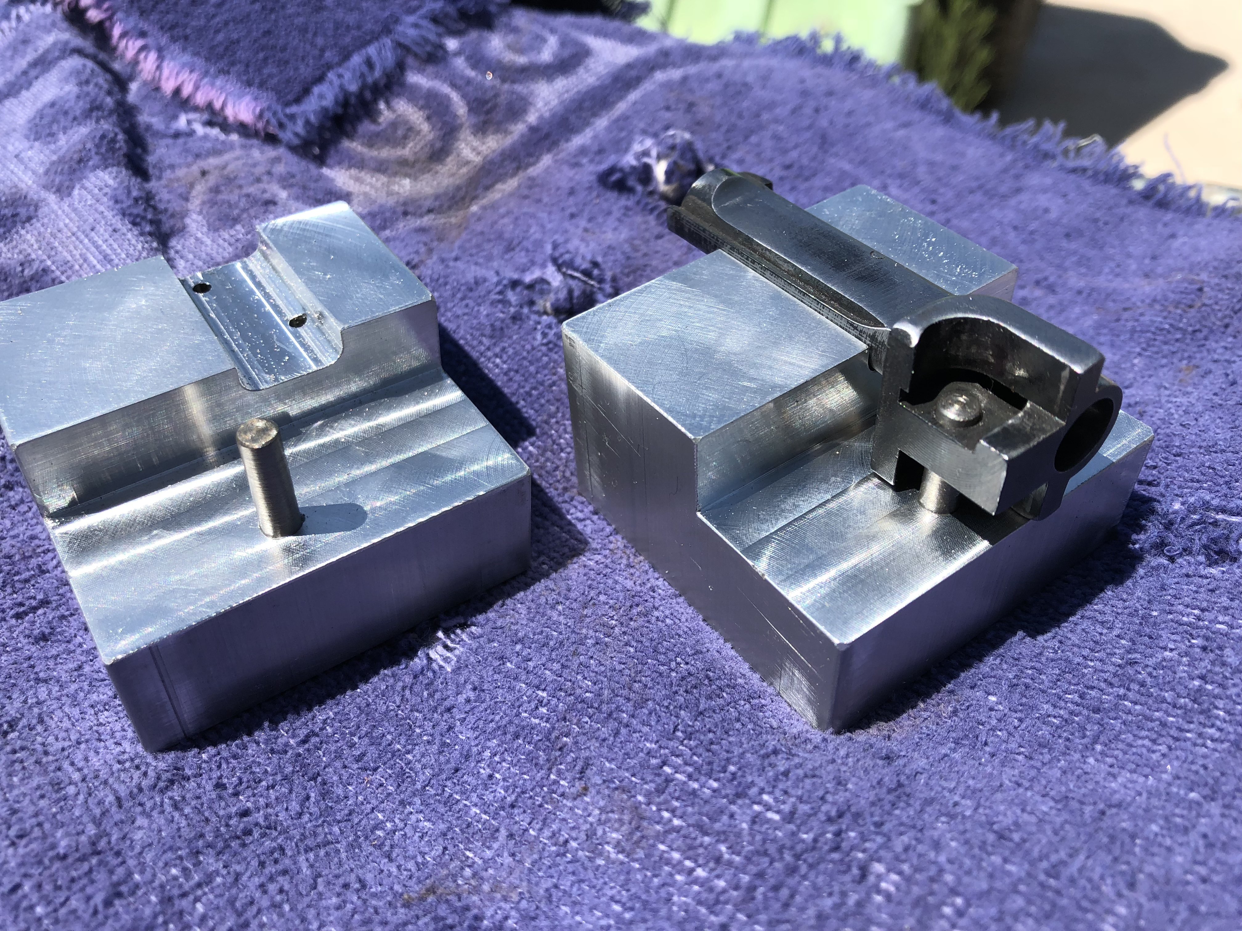

Not Dead Ed Posted October 12, 2021 Posted October 12, 2021 Check out Bullets by Scarlett, #ScarlettDarlin she and others sell a jig that helps hold everything in the right place and then you can tap out the pin. Bought one from her at EOT. Makes the job a cinch. you’ll need to pull the bolt too, obviously.

Hendo Posted October 12, 2021 Posted October 12, 2021 I got my bench block from @KingSnake. It works great.

KingSnake Posted October 12, 2021 Posted October 12, 2021 Scarlet Darlin and I both offer this Bolt Bench Block. We also offer a pin punch and replacement pin material.
Not Dead Ed Posted October 12, 2021 Posted October 12, 2021 5 minutes ago, KingSnake said: Scarlet Darlin and I both offer this Bolt Bench Block. We also offer a pin punch and replacement pin material. Got one, works like a charm!

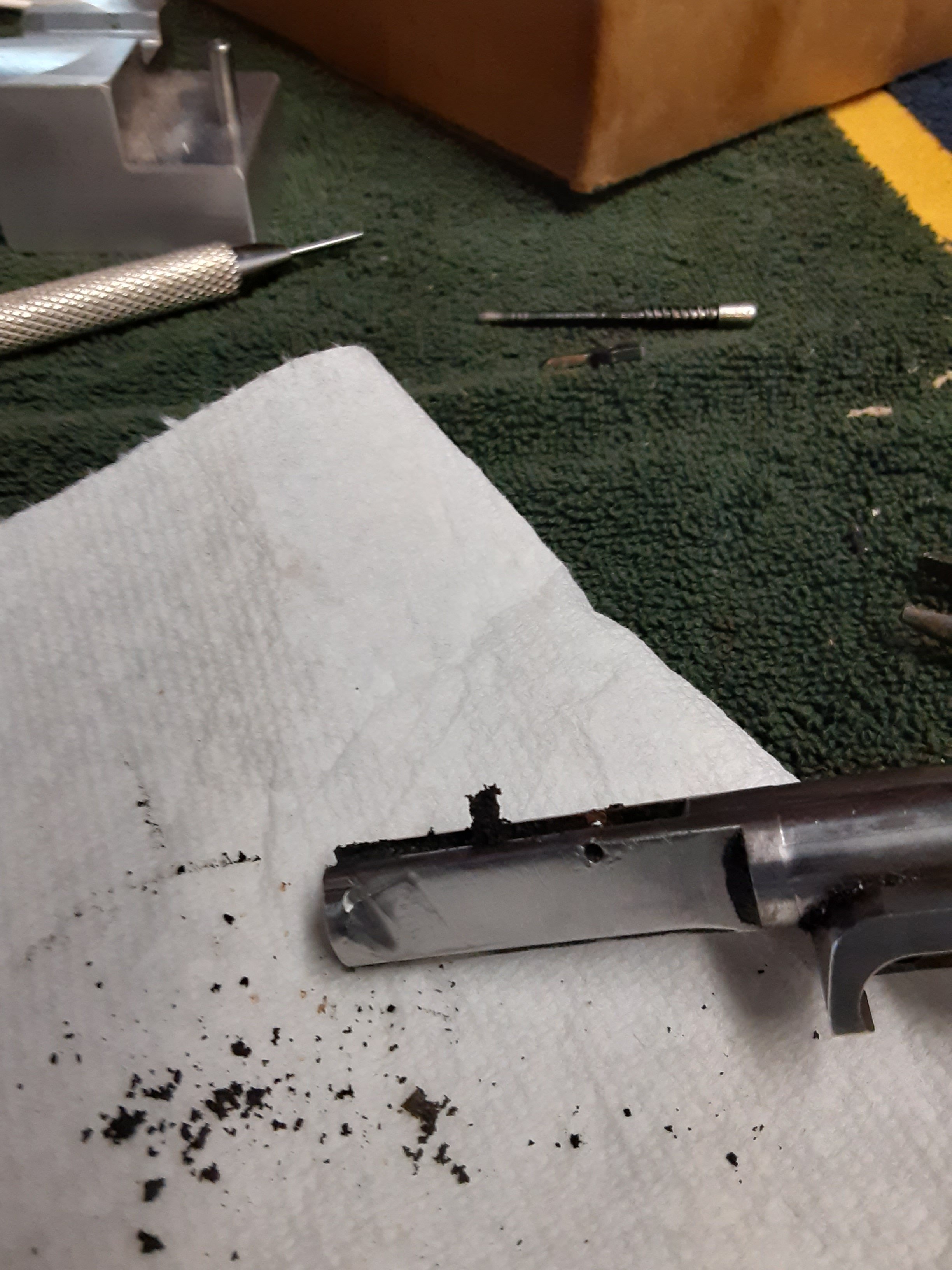

Scarlett Posted October 12, 2021 Posted October 12, 2021 7 hours ago, G W Wade said: My question if I may. Why are you removing the extractor so often. I don't shoot as much as a lot of you due to weather up here but I havn't removed one from my rifle in 15 yrs GW Plus, if you shoot Black Powder (or substitute) it WILL get gunky. See before and after pictures. BEFORE AFTER:

Cutthroat Cody Posted October 15, 2021 Author Posted October 15, 2021 I bought that extractor jig from Scarlett Darling and when I took it out, OMG to say the least........
Garrison Joe, SASS #60708 Posted October 16, 2021 Posted October 16, 2021 Yep. Clean the firing pin channel where you are in there! It's almost that bad, most likely. good luck, GJ

Scarlett Posted October 16, 2021 Posted October 16, 2021 1 hour ago, Cutthroat Cody said: I bought that extractor jig from Scarlett Darling and when I took it out, OMG to say the least........ I know, right?! It’s crazy how much gunk is up in there! Glad the jig worked and your extractor is clean! Happy shooting! Hugs! Scarlett 1 hour ago, Garrison Joe, SASS #60708 said: Yep. Clean the firing pin channel where you are in there! It's almost that bad, most likely. good luck, GJ I clean mine frequently! It’s never been as bad as my extractor! Hugs! Scarlett
