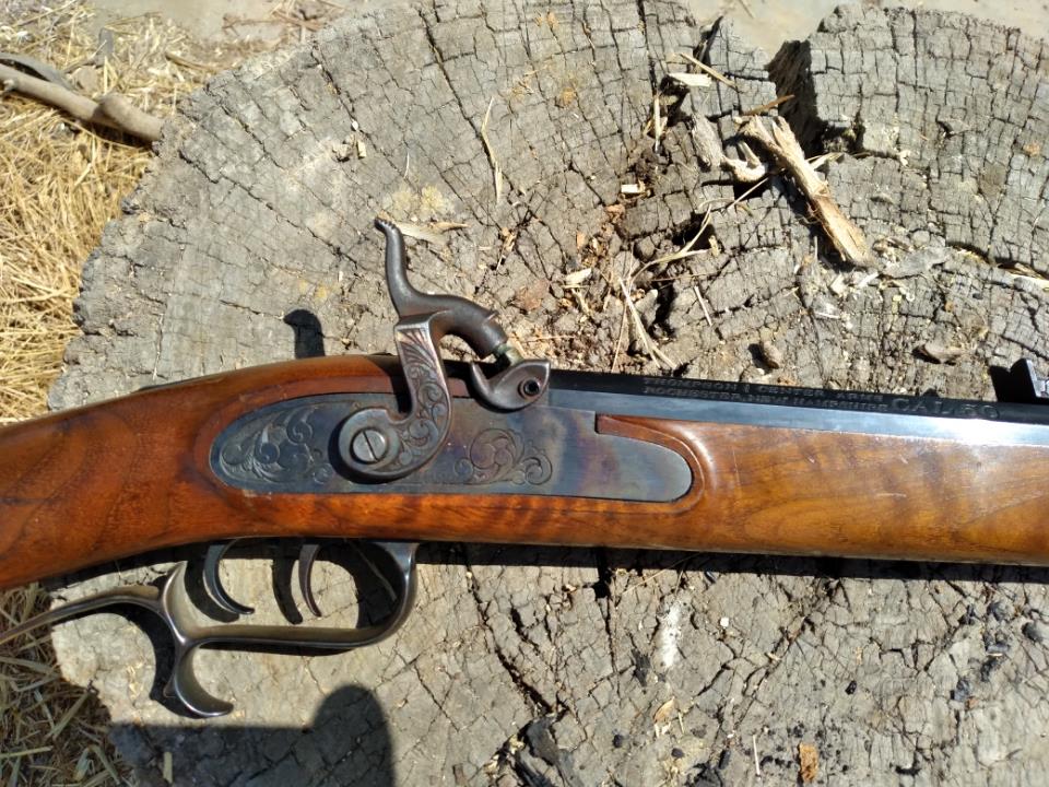

El CupAJoe Posted September 3, 2021 Posted September 3, 2021 This year I'll attempt to take my second ever deer during muzzleloader season using a TC Hawken that was gifted to me. I didn't think that I would like the gun at first, but when shouldering it, it seems like it was custom fit for me. I'll be working up a load for it this week end using a 50 cal 360 minie mold I purchase from Lee and some home made sizers to get the diameter where I want them. My question is, I'd like to add a traditional sling, but I'm pretty sure sling swivels are a modern invention and I was wondering if any of you had pictures of how your guns might be slung using more traditional methods when not equipped with the hardware for a sling.

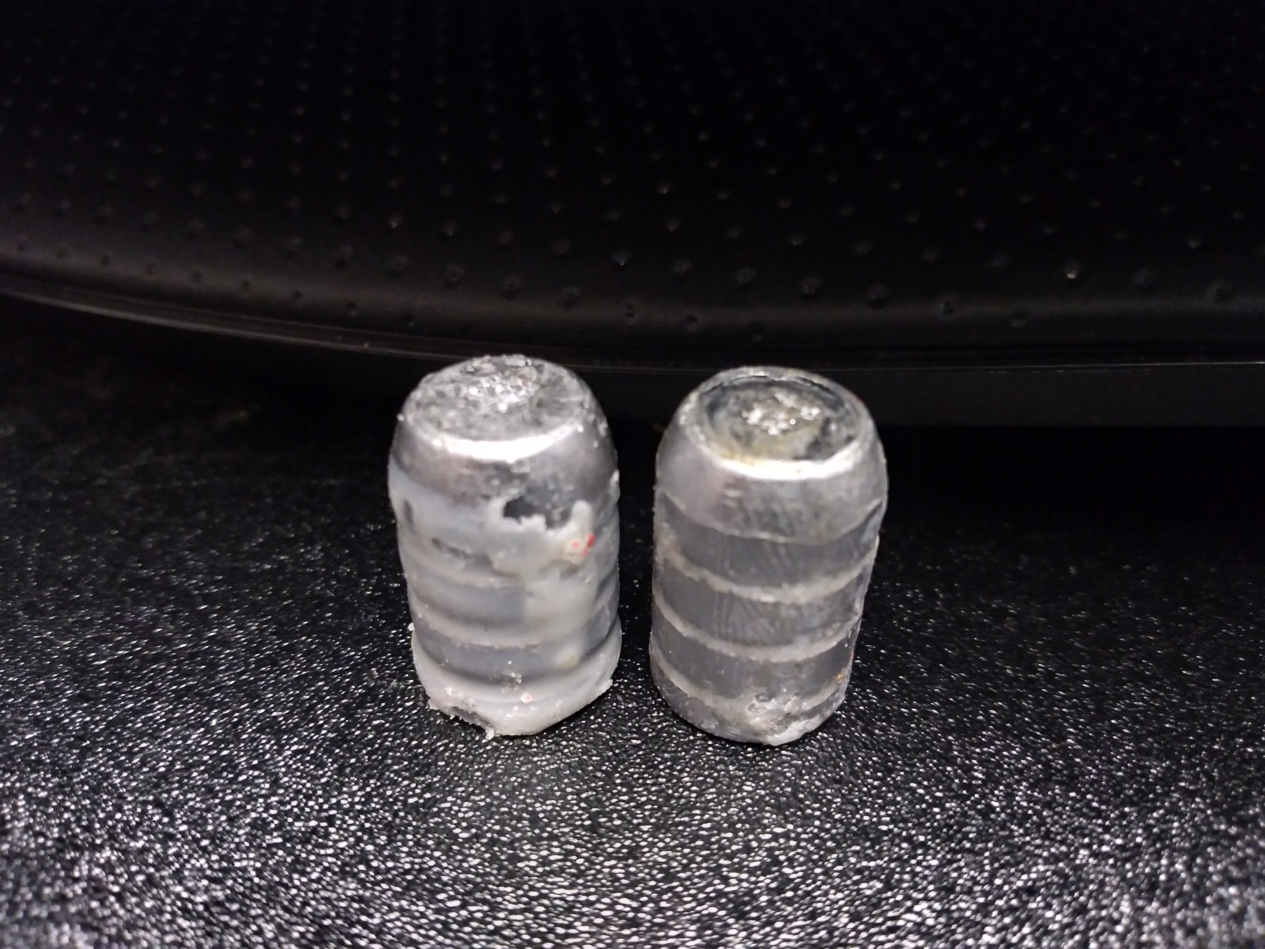

El CupAJoe Posted September 7, 2021 Author Posted September 7, 2021 On 9/3/2021 at 3:41 PM, Hardpan Curmudgeon SASS #8967 said: Joe, please let us know how those Minie balls work out. looks like I need some more time to figure the load out. I was in a bit of a rush yesterday, but I tried 60, 70 and 90 grain loads trying to get them to group no success. pictured are as cast, second pic is lubed unsized on left and sized to .496 on the right.
J-BAR #18287 Posted September 7, 2021 Posted September 7, 2021 I would go with even lower powder charges to get the group you want. A projectile that heavy is going to plow all the way through a deer at whatever range you hit it. You will not need heavy powder charges to achieve penetration. Go down to 45 grains and work up 5 grains at a time. Swab the bore after every two shots. It’s time consuming but having confidence in your load is worth it when hunting.
