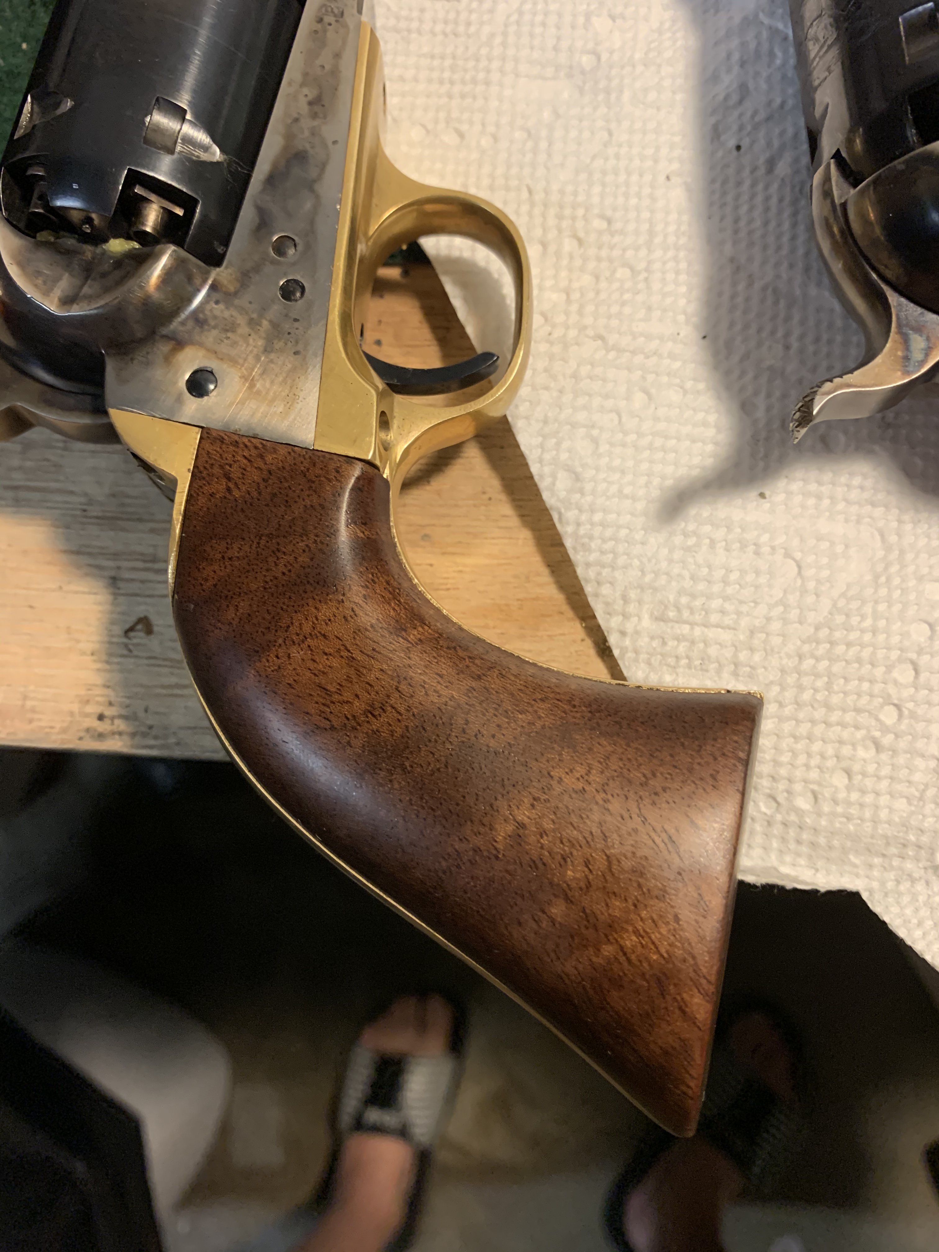

Hendo Posted April 27, 2020 Posted April 27, 2020 I did my pistols and my rifle. The poly sucks to get off, but they came out nice using Tru-oil. Post up pics as you go.
John Boy Posted April 27, 2020 Posted April 27, 2020 Checker the grips and one will have no issues of slippery Grips, regardless of the finish
Tequila Shooter Posted April 27, 2020 Posted April 27, 2020 5 hours ago, Hendo said: I did my pistols and my rifle. The poly sucks to get off, but they came out nice using Tru-oil. Post up pics as you go. They came out good. I did a second pair of grips the other day. If I ever get caught up on the honey do list I may just tackle the shotgun.
