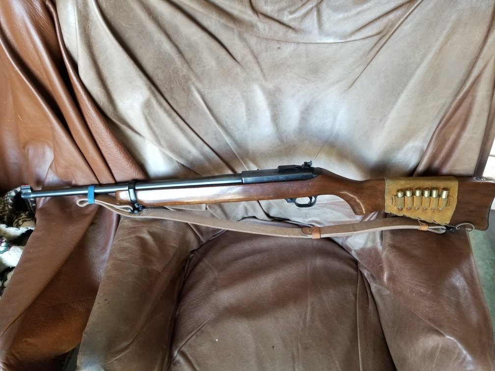

My 10/22 is all grown up!!
             Jasper
             Jasper
Aw yea, indeed..... the perfect woods rifle.
I had one a few years back with the shorter style stock (no barrel band).   I don't know why I let it go, but I'm sure it was for a stupid reason... :o
P.S. - nice rifle, Jasper.
..........Widder
