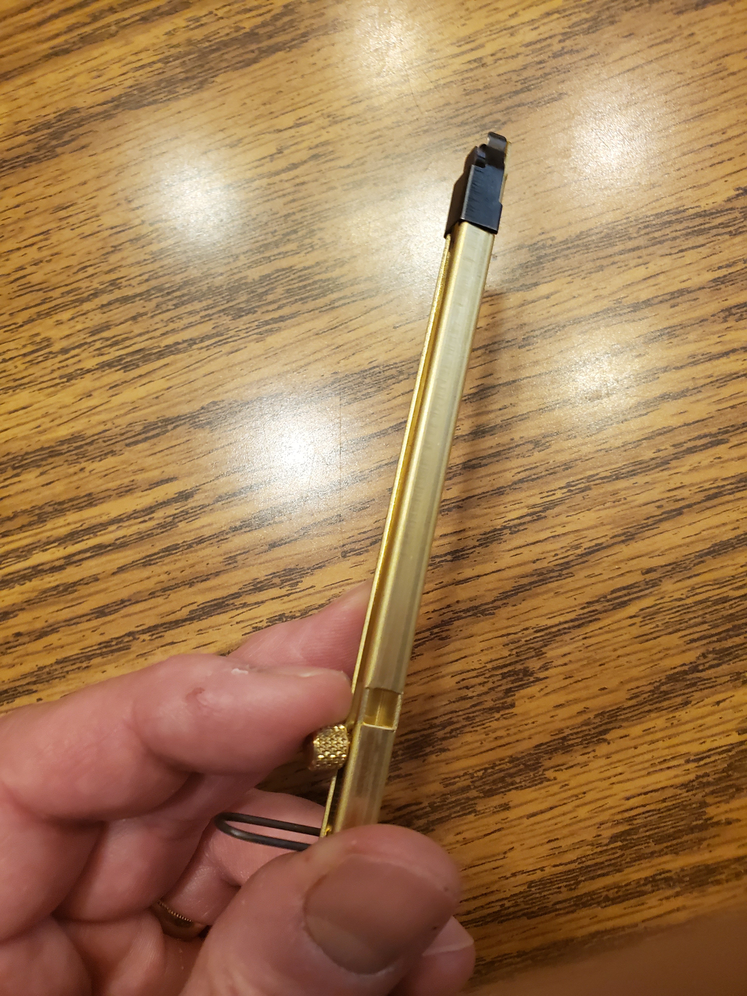

Tyrel Cody Posted July 10, 2019 Posted July 10, 2019 @Prairie Dawg, SASS #50329 (or anyone else for that matter) have you seen Ted Cash's redesigned inline cappers? I ordered a couple and they now load from the side, kind of neat. Instructions say they'll work with any revolver now. But look to me like they'll still need a little filing/grinding.
Marshal Hangtree Posted July 10, 2019 Posted July 10, 2019 Loading the caps 1 at a time through that slot?
Tyrel Cody Posted July 10, 2019 Author Posted July 10, 2019 Just now, Marshal Hangtree said: Loading the caps 1 at a time through that slot? The older ones are one at a time from the bottom.
Marshal Hangtree Posted July 10, 2019 Posted July 10, 2019 OK, I can see how the side load would tend to be more consistent.
Tyrel Cody Posted July 10, 2019 Author Posted July 10, 2019 Yeah, they're real easy to flip sideways from the bottom.

Tyrel Cody Posted July 10, 2019 Author Posted July 10, 2019 One needed the entry hole widened just a smidgen for number 11 caps, the other was fine, but probably could use just a tad of filing of the side opening. They are easier for me to load from the side, no caps turned on their side like the bottom load versions. The end of these new ones are better as well as there are no little prongs present(they have to be ground off the old ones to work on an 1851). So far so good and imo improved.
Prairie Dawg, SASS #50329 Posted July 10, 2019 Posted July 10, 2019 About 1/2 the Remington #10 caps are just a smige too tall & bind going down the in-line capper. So, I use them in a teardrop capper. But I prefer in-lines Been like that for the last ten years or so. Have you noticed any problem with using #10s in your in-line cappers? --Dawg
Tyrel Cody Posted July 10, 2019 Author Posted July 10, 2019 Dawg, I haven't had any problem with the Cash inlines and tall caps yet. I've only been through 300 or so caps though; I'll keep my fingers crossed.
Prairie Dawg, SASS #50329 Posted July 10, 2019 Posted July 10, 2019 Yep, some batches run thru really well. However, some batches don't, and it is really frustrating. For those I use teardrop cappers. (not my preference) Tried the polish capper (Didn't care for it) I've got maybe 30K Remington #10s at home and have to keep track of the lot #s, cuz some are just too deep/tall for the channel inside a TDC in-line. Thanks for the heads-up. I'll order a couple & see if they work better than my 25 vintage ones! Stay cool my friend! --Dawg
Tyrel Cody Posted July 10, 2019 Author Posted July 10, 2019 22 minutes ago, Prairie Dawg, SASS #50329 said: I'll order a couple & see if they work better than my 25 vintage ones! Be ready with a needle file. The #10 Remingtons seem to fit ok, after you get them through the slot. One of mine is a REAL tight fit. I will be sending TDC a note that the opening needs to be a tad larger.
Kid Rich Posted July 11, 2019 Posted July 11, 2019 I have some inlines that the #10's do not work well with, others that I have the 10's work fine in. kr
Clyde Henry 7046 Posted July 11, 2019 Posted July 11, 2019 5 hours ago, Prairie Dawg, SASS #50329 said: About 1/2 the Remington #10 caps are just a smige too tall & bind going down the in-line capper. So, I use them in a teardrop capper. But I prefer in-lines Been like that for the last ten years or so. Have you noticed any problem with using #10s in your in-line cappers? --Dawg Ya, I have the same problem with the Remington # 10s in TC in-line cappers, its the pits.
Prairie Dawg, SASS #50329 Posted July 11, 2019 Posted July 11, 2019 I contacted TDC products. The only thing that has changed is the method for loading the caps. The dimensions of the brass channel that holds all the caps has not changed. Really, just a cosmetic change, IMHO. From their Website: CCI #10 Caps are all trimmed to .160 and they all work very good in our Straightline!Remington #10 caps vary in height from .176- .185,most work ok if they go over .180, they stickRemington #11 caps Vary in height from .146-.150, they all work good. So, rather than make a product that suits our needs, they expect us to use caps that do not fit the nipples we use in our guns. She said that I should switch to CCI caps, which was kinda stupid, since they don't fit properly. I did point out to the person with whom I corresponded that most cowboy shooters use Remington #10, and that their in-line capper is recommended for caps that do not fit our nipples, but I don't expect them to change. So, I will continue to do things the way I have been, venting my frustration from time-to-time! --Dawg
