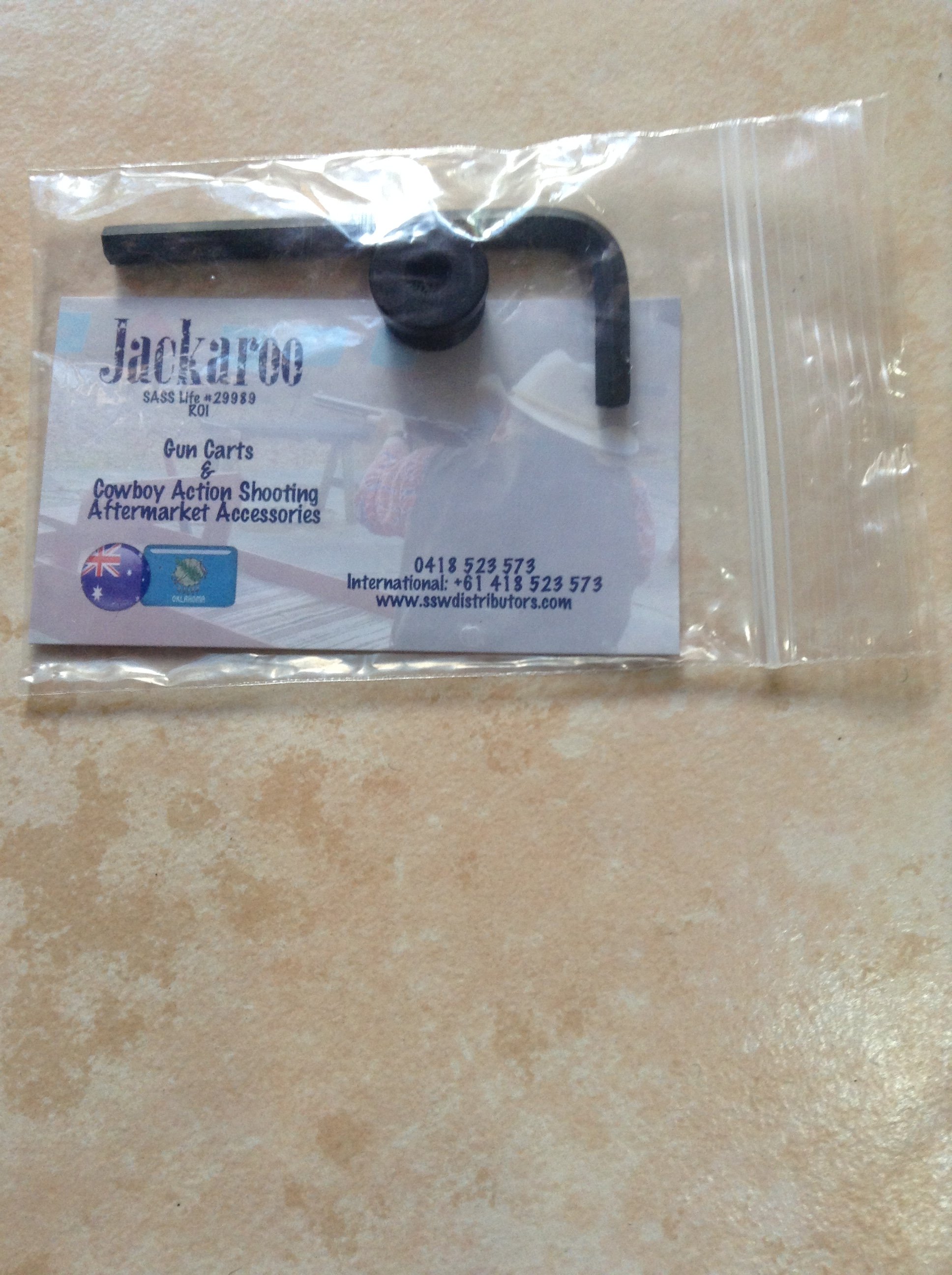

Lawman Mays Posted March 26, 2019 Posted March 26, 2019 Scrub Oak Willie in Tennessee, 423-881-5685, makes a socket head magazine tube plug for the Uberti 66 and 73 rifles. I got one. Much easier to take off with an allen wrench.
Scrub Oak Willie 53737 Posted March 26, 2019 Posted March 26, 2019 Thanks for the plug for my plug Lawman : If anyone wants one you can also contact me at scruboakwillie@gmail.com Willie

Jackaroo, # 29989 Posted April 16, 2019 Posted April 16, 2019 On 27 March 2019 at 2:33 AM, Scrub Oak Willie 53737 said: Thanks for the plug for my plug Lawman : If anyone wants one you can also contact me at scruboakwillie@gmail.com Willie Or me if you're in Ozzie.
