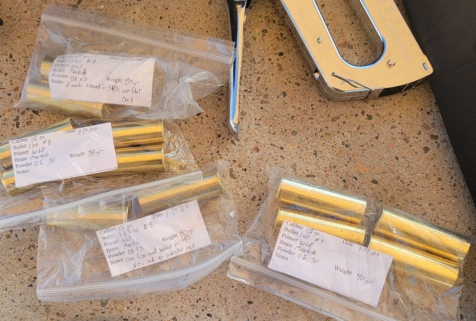

Dapper Dave Posted February 1, 2025 Posted February 1, 2025 Definitely don't lose this one - I just got into this fun little side gig! Quote
