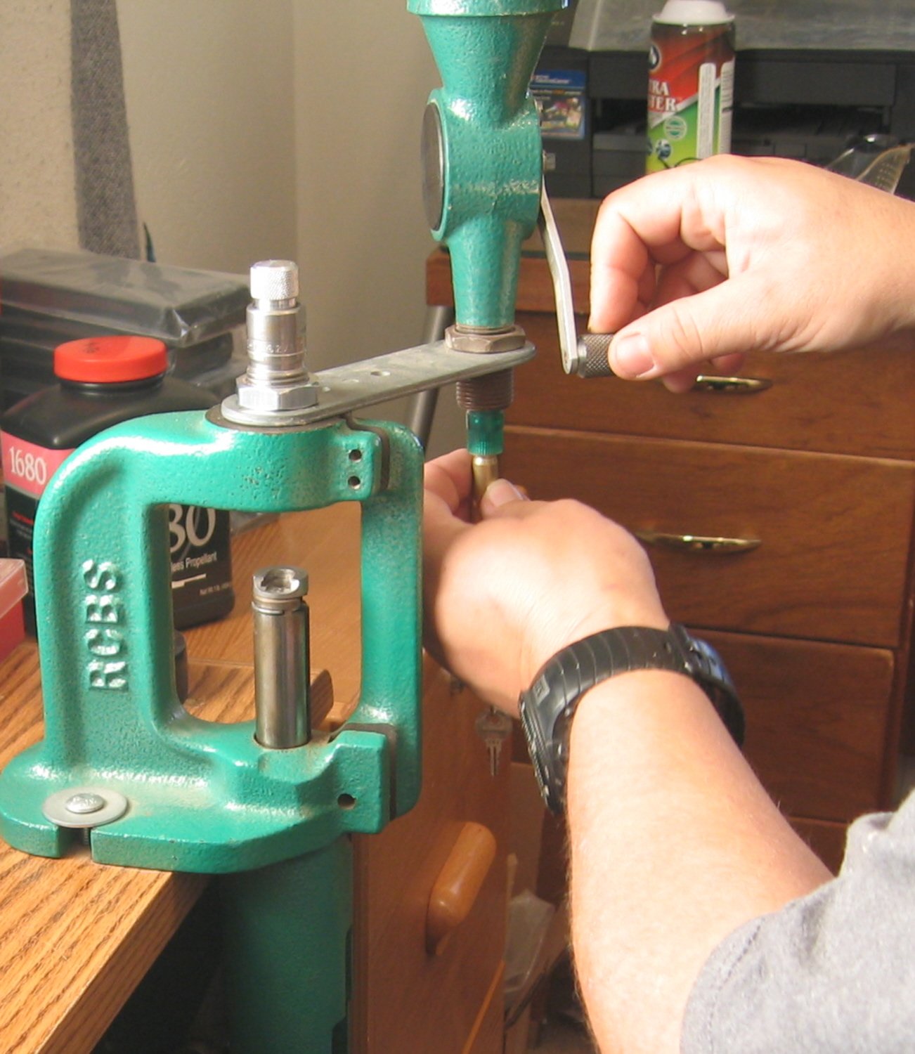

These first photos are of the RCBS with a 12ga shell in the press.
This is the 12ga shell holder.  It fits without any problem.
The 10ga shells present their own set of minor issues.  The shell holder must be modified in order to fit it into the press.
The first picture is of the shell holder by itself. Notice that I have ground off some material on the left side of the shell holder. This allows it to clear the frame of the press when it is being installed.
This pic shows the 10ga shell holder installed.
In order to get the shell holder into the press, it has to be put in with the narrowed side facing the frame and then turned to accept the shell.
You COULD just grind the right side of the shell holder, but I use that same one to prime the shells that take large pistol primers on an RCBS primer station, (shown below). By narrowing the left side, it allows me to use the primer station with the primer feed tool and it seats the primers correctly.
This shot shows the 10ga shell holder installed on the RCBS primer station with the primer drop in position to set a primer.
I’ve included a couple of photos of the CH4D die.  This is the 12ga roll crimp die.  From the outside, the 10 and 12ga dies are identical. I didn’t show the sizing and depriming die.
This is a top view with the die installed in the press.  The top knob adjusts the depth of the over shot card and seats it on the shot evenly.
The whole assembly! Set up with the 10ga shell holder.
The dies come with a lock ring,(set screw not shown) to set the amount of roll crimp.  I have two different length shells in both 10 and 12ga, so this allows me to adjust depth for each length.
Here’s a sample of the finished product in both 10ga and 12ga along with a shot of the Alcan zinc shell.

Very nice, thank you, sir! My only press is an RCBS RS from 1981 - do you think that setup will work on that one?
It depends on whether or not that press will accept the 1 1/4” dies.  The RCII has a screw in bushing that allows the 7/8” standard dies to be used. You must remove that bushing to use the bigger dies.
Edited by Blackwater 53393
Ah, no, then it won't work, this is setup for only the standard dies, no bushing. Oh well, was worth a look.
If you wanted to fool with it, you could take your press to a competent machine shop and have them bore and tap that press for the bushing. It certainly looks like there’s enough metal there to accommodate the bushing.
I wouldn’t recommend using it for reloading .50 BMG, but for building up brass and even plastic or paper shells it would probably work just fine!
I WILL tell you that for the CH4D sizing die, you’ll want to replace the regular handle/lever with a longer one. Inline Manufacturing makes ‘em for nearly every press out there!  I love mine!!
