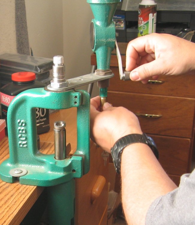

Warden Callaway Posted May 27, 2016 Posted May 27, 2016 The Polish Pistolaro video show using the RCBS die set. Frankly, I think most people can reload brass hulls with nearly no tools. A punch to knock out primer, a dowel and plate of steel to seat new one. Same dowel to seat over powder card. Here is Bottom Dealing Mike aka duelist1954 demonstrating the nail and dowel method. Just substitute brass hull and large pistol primer. Quote

Major Art Tillery Posted May 28, 2016 Posted May 28, 2016 Will the RCBS 12 ga. Brass reloading die re-size the 12 ga. brass case ? The info states it will roll crimp, no mention of resizing. Loaded these with say APP maybe 8+ times, I have yet to resize any of them. I figure the low pressure of the BP sub never really gets them to expand to much. BUT DANG THEY ARE HOT TO PICK UP! Quote

Lefty Dude, SASS # 51223 Posted May 28, 2016 Posted May 28, 2016 I have been loading Brass SG's for now on to 7 or 8 years. I have found that by re-sizing the base with my MEC Super-Sizer each time my nitro cards fit tighter over the BP. . I load by using my hand tools, and have wondered how the RCBS dies would work, maybe I am missing something. When I prepare new cases for the first time loading, I size the case with my 12 ga. Lee Loader and plastic mallet. Also prep the flash hole to proper size and ream the primer pocket. Both of which are usually not very well finished or of the proper size. Just curious about the RCBS die. Quote
Graywolf Tate Posted May 28, 2016 Posted May 28, 2016 I bought the RCBS die set and am not greatly impressed. The resizing ring that screws into the die body has not had to do any work on my Magtech shells. The shaft that holds the decapping die is held in place by clips and they bent and came off the shaft so I am using the shaft to manually decap over the hole in my bench anvil. Not really worth the price, but that's just my opinion. I also have found that 1/2 " wads blow a hole in the pattern just about the size of 6-8" knockdowns. I put together a 1 oz square load , nitro card, shot and overshot card sealed with waterglass. Out of my Stoeger Coach, it holds a nice tight pattern at our distances which is the only thing I use them for. Quote
