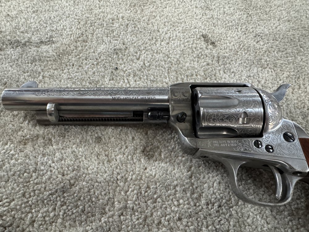

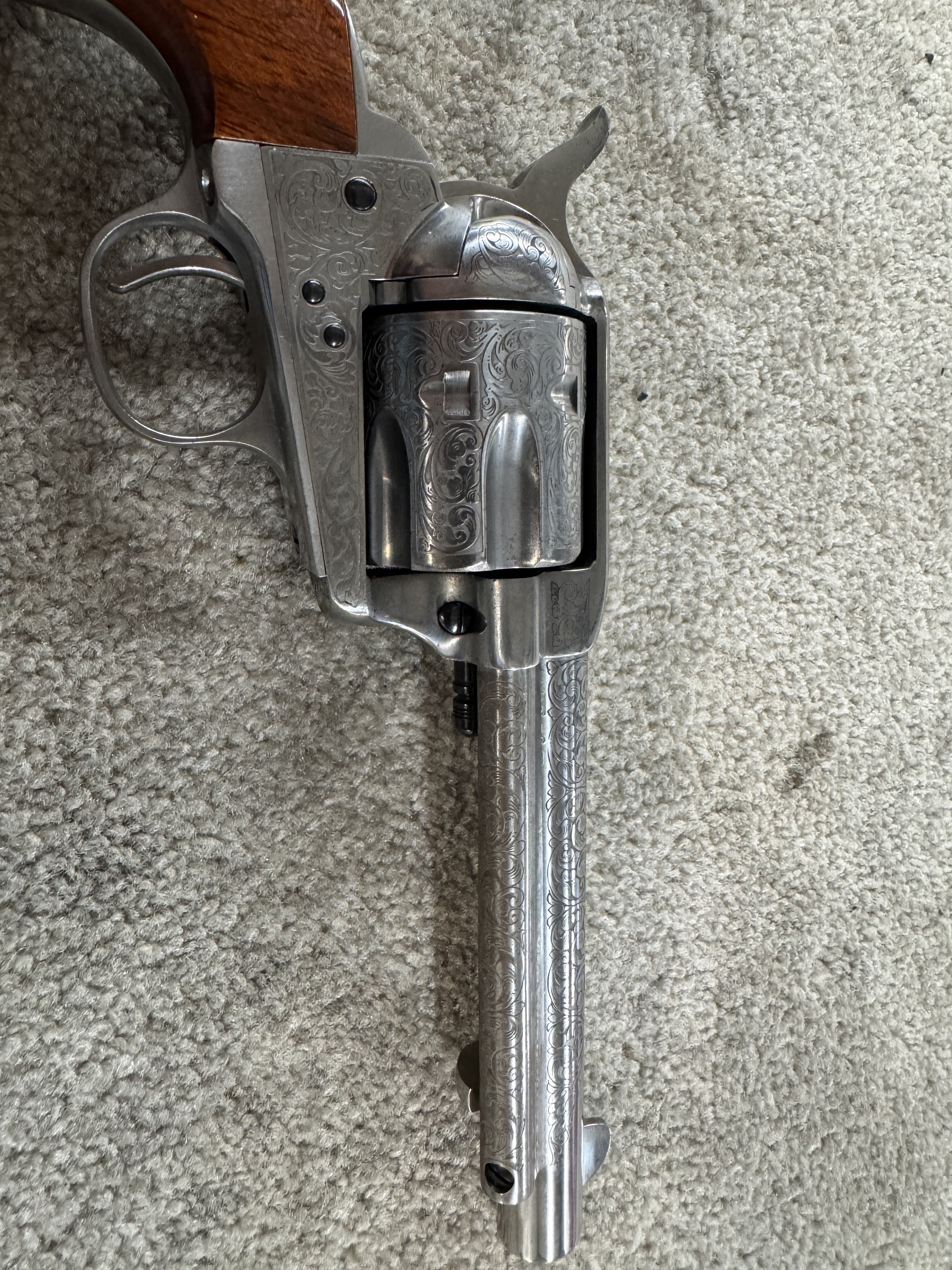

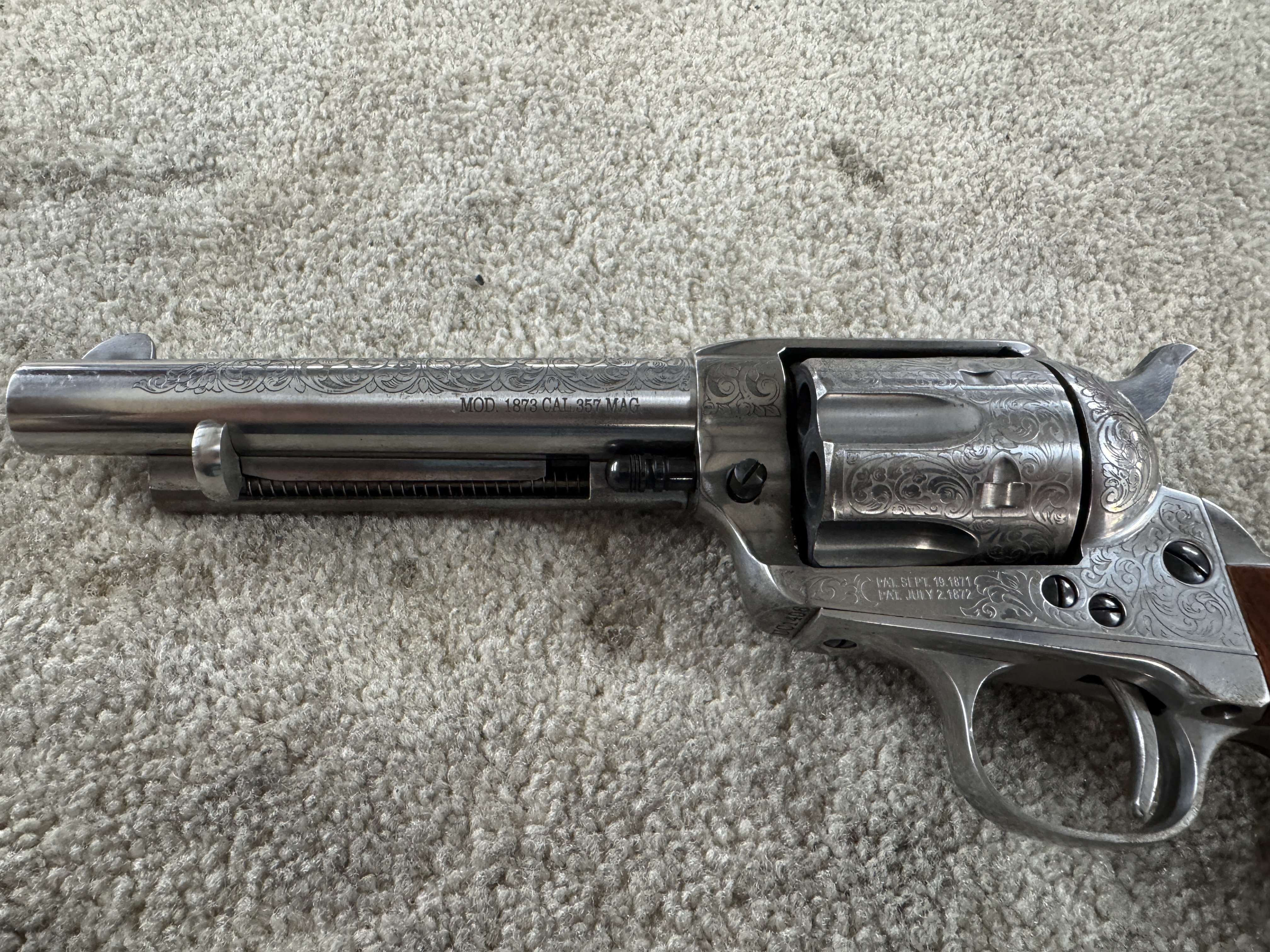

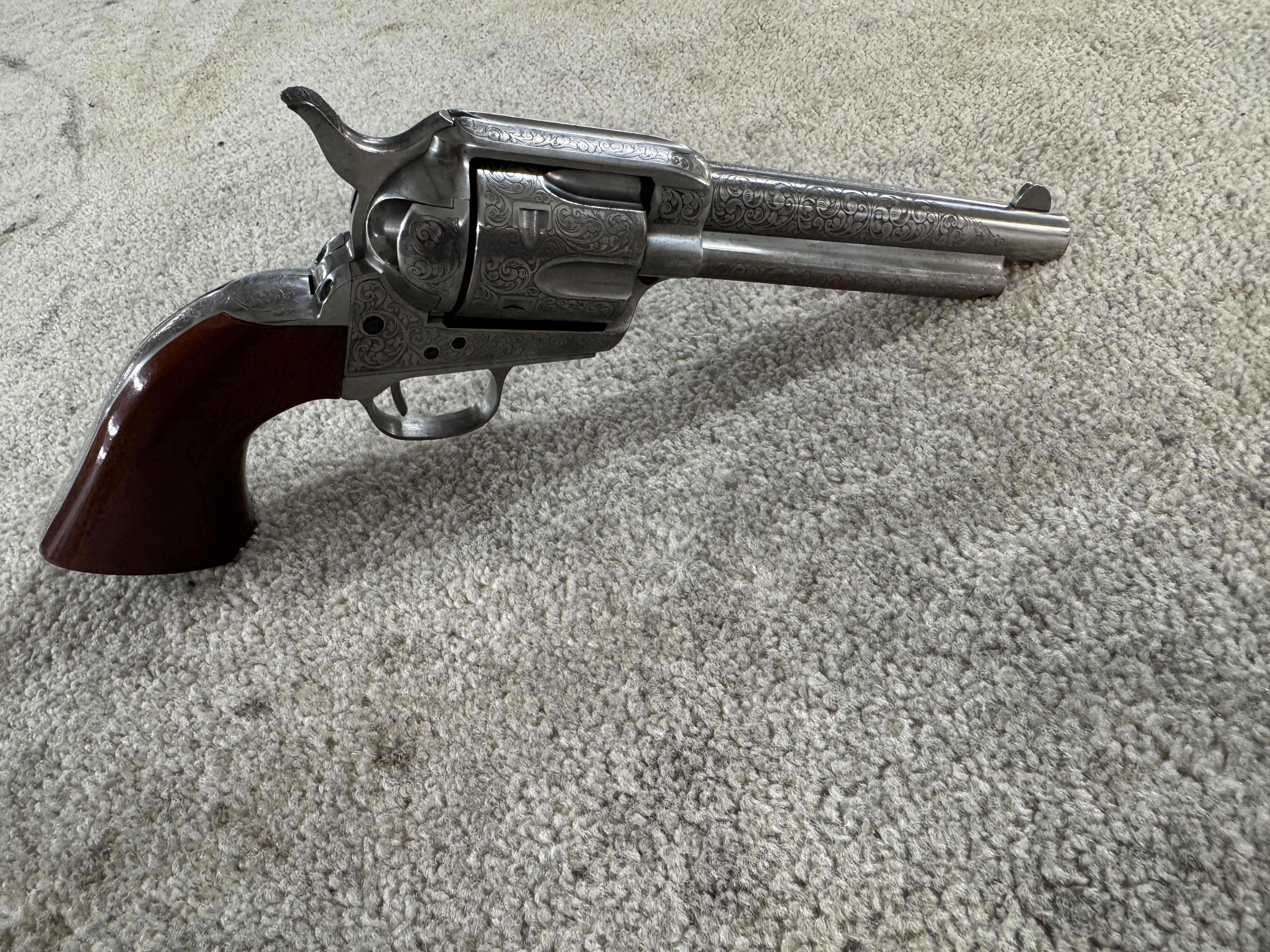

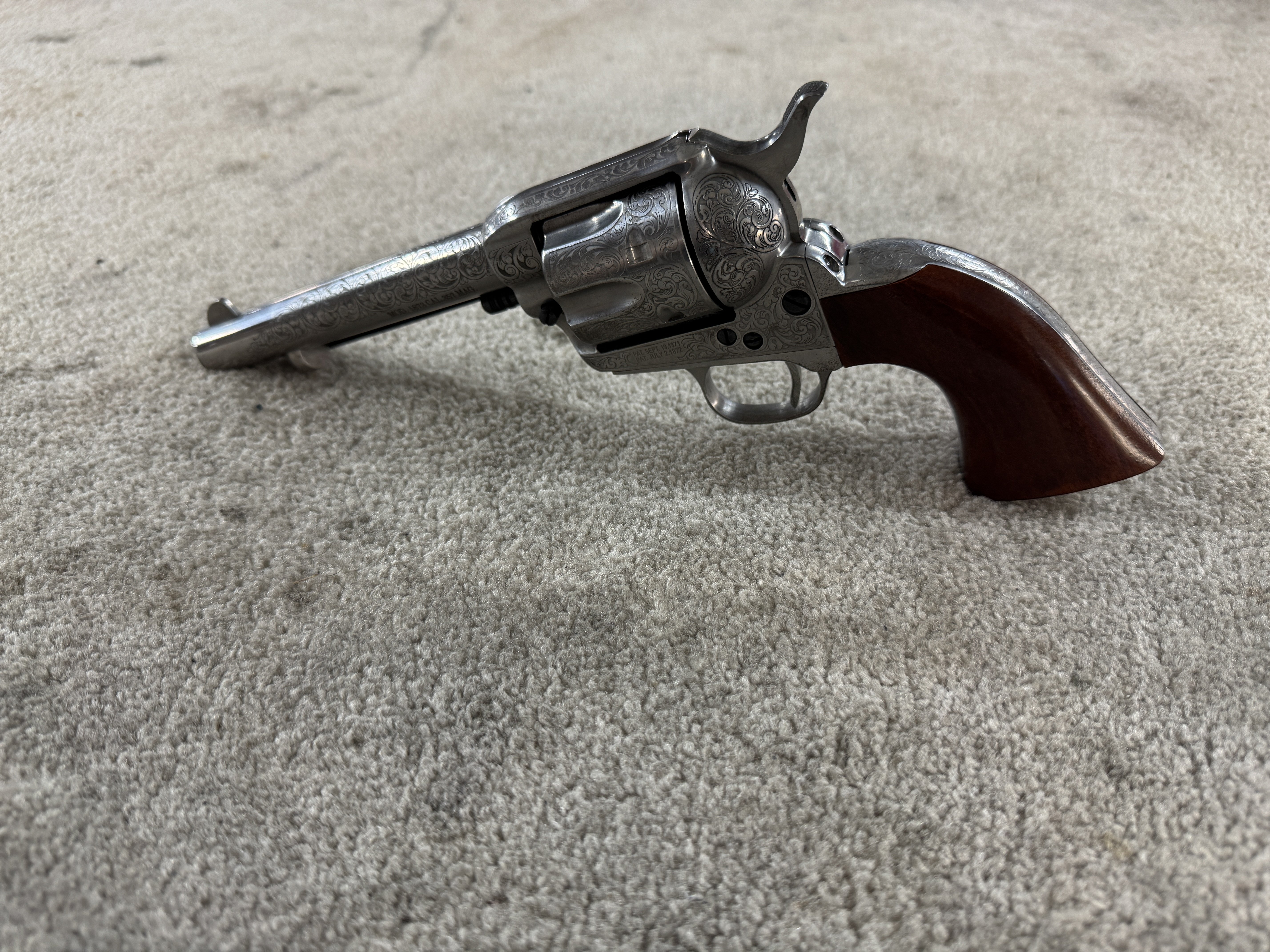

  14. Taylor & Company 1873 Cattleman SS White Floral Engraved Finish 5 1/2" Barrel 357 Mag Walnut Grip. No Box Like New $625 shipped to your FFL

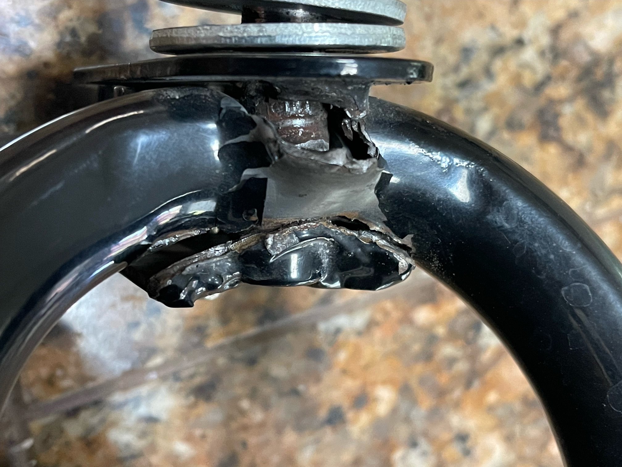

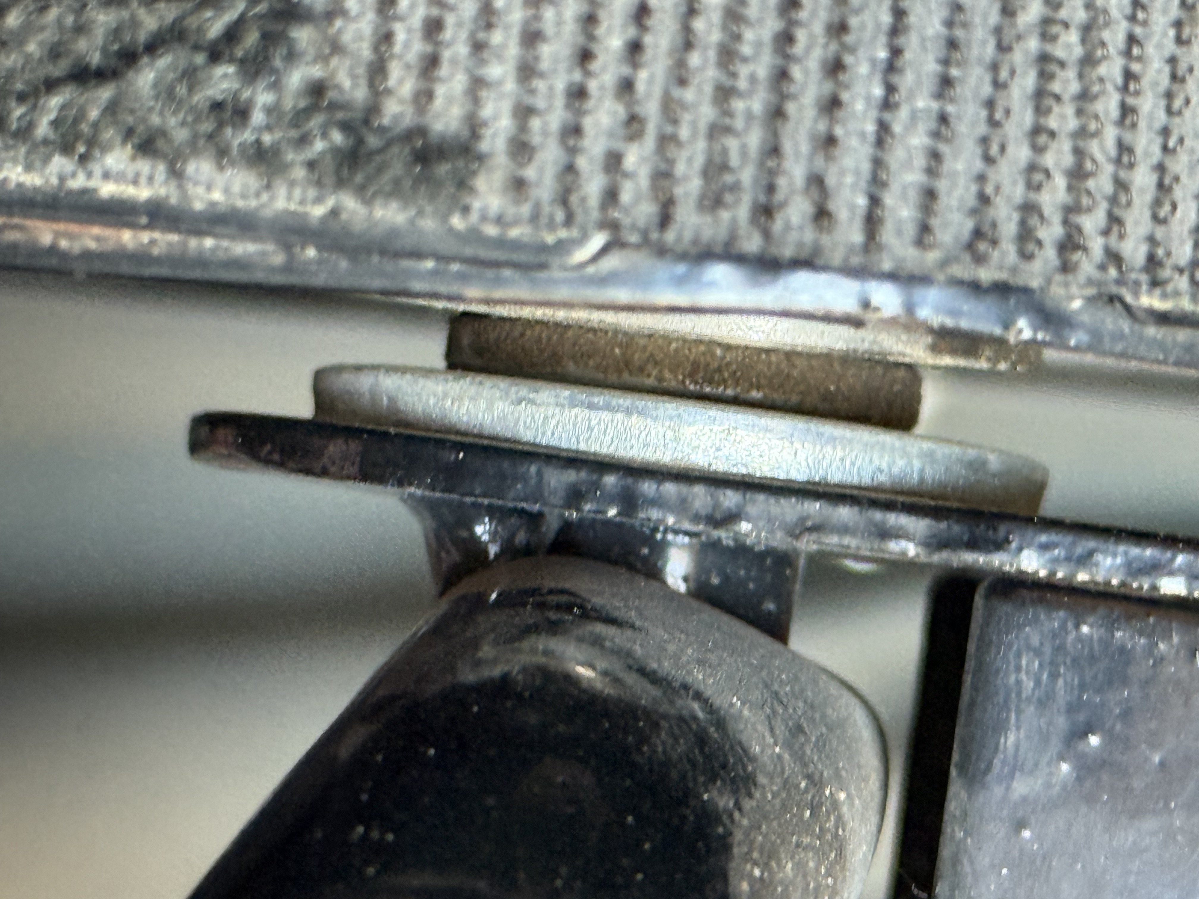

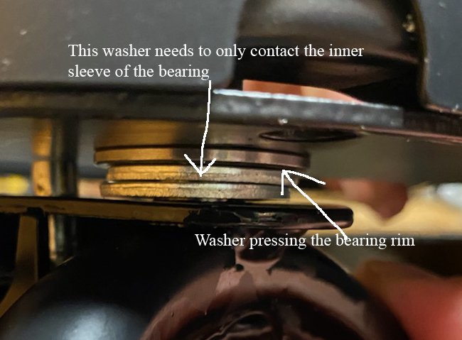

  16. I spoke with Barb at Rugged Gun Cart last September. Our front kork was destroyed . See photo. We got a replacement for $25, a fair price. I installed it with her assistance see photo. After a few exchanges I was unhappy with the recommended installation, so I replaced one of the suggested washers with a 3/4 split ring washer. See photo. This solved the problem. The wheel now turns using the bearing and the top nut is fully tightened, keeping the folk solid. I have installed this system for other users.
