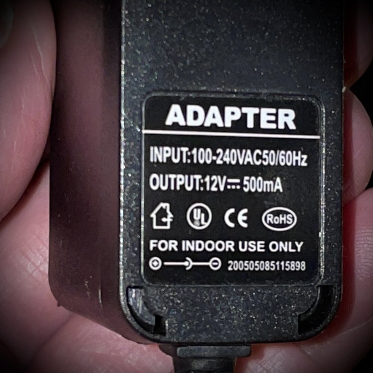

Nostrum Damus SASS #110702 Posted January 16, 2023 Author Posted January 16, 2023 19 minutes ago, August West, SASS #45079 said: The information label on my case feeder power bricks says: 500 mA at 110 volts. So, they draw about 55-60 watts (if my math is correct). The reed switch that controls the feeder makes this draw intermittent, governed by how fast you're pulling the crank. Thanks AW. I think you are correct, and 60W usually means 60W continuous. The peak current draw at start-up is usually about double the continuous draw, so the more economical 300W units are easily powerful enough to do this job.
August West, SASS #45079 Posted January 16, 2023 Posted January 16, 2023 6 minutes ago, Nostrum Damus SASS #110702 said: Thanks AW. I think you are correct, and 60W usually means 60W continuous. The peak current draw at start-up is usually about double the continuous draw, so the more economical 300W units are easily powerful enough to do this job. The motor may be DC controlled, which means there is no capacitor and, therefore, no startup overdraw. As you know, the motor is controlled by the reed switch in the case feeder drop tube. So, the power demand is intermittent. The first calculation was at 110 volts. But, the output of the brick is 12 volts. At 12 volts, 500 mA would be 6 watts continuous rather than 60. Whatever the case (no pun intended), it should not take many watt hours of storage to keep the Dillon running for quite a long time. Let us know how this works out in real life.
Cliff Hanger #3720LR Posted January 16, 2023 Posted January 16, 2023 12 volts dc at 500 ma = 6 watts ------------------------------ You want to know your battery supply total amps available. Divide that by the 500 ma (.5 amps) to get your duration of maximum use. I run a lot of RC models. My biggest battery is a 12 volt 3500 ma battery. Size is about 1.14"x2.5"x7". I can run those models for about 3 hours before I notice speed drop off. There are 2 motors, 2 speed controllers and 4 servos operating pulling from the battery. In theory a small car 12 volt battery at say, 40 amps capacity should run for about 80 hours at 100% out put at 500 ma (.5 amps)
