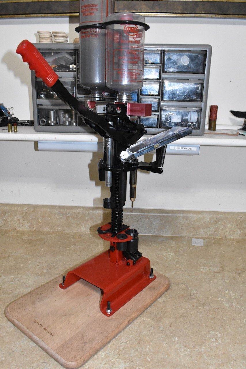

Marauder SASS #13056 Posted September 1, 2022 Posted September 1, 2022 Start with your Dad's. I had a MEC Jr I bought used. It was okay but slow. Then I upgraded to a used MEC 650 and it is so much faster. I did have to buy a separate Super SIzer (that is a sizing tool). Again, a used one that was MUCH less than new. I'm happy with the combination. Helped a friend get the upgraded Grabber that resizes as well as the 650 "progressive" functions. It is nice but takes just a little more adjusting. I like the simplicity of the 650 with a super sizer best. As mentioned, you can get replacement/upgraded parts as I did for a few things that really helped. The Lee is okay, but does not do the final finish of the shell that the MEC 650 and above do.

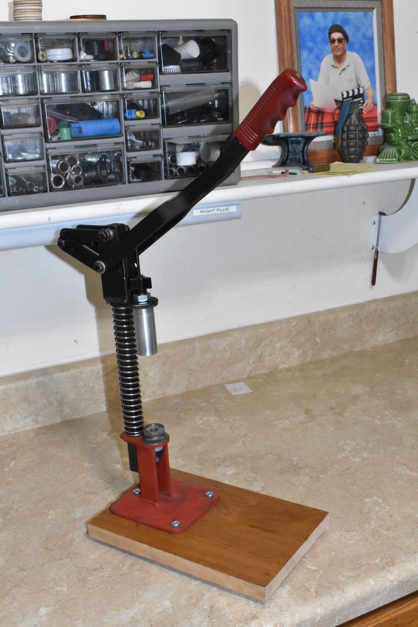

Larsen E. Pettifogger, SASS #32933 Posted September 1, 2022 Posted September 1, 2022 A lot depends on how much you intend to reload. I have had the RCBS Grand, Dillon 900 and pretty much everything else at various times. Right now I have three. The first is a Mec 600 Jr. set up for loading 2 1/2" BP loads. The next is a Mec Sizemaster for CAS smokeless loads. The last is a powered Spolar for trap and other competitive shotgun sports. For CAS I like the Sizemaster over the Junior as it has a collet sizer while the Junior uses a ring sizer. For my CAS shells I run them all through a Roger Rapid taper die. This one is mounted on an old Mec shell conditioning press.

Randy Saint Eagle, SASS # 64903 Posted September 2, 2022 Posted September 2, 2022 On 9/1/2022 at 10:17 AM, Marauder SASS #13056 said: Start with your Dad's. I had a MEC Jr I bought used. It was okay but slow. Then I upgraded to a used MEC 650 and it is so much faster. I did have to buy a separate Super SIzer (that is a sizing tool). Again, a used one that was MUCH less than new. I'm happy with the combination. Helped a friend get the upgraded Grabber that resizes as well as the 650 "progressive" functions. It is nice but takes just a little more adjusting. I like the simplicity of the 650 with a super sizer best. As mentioned, you can get replacement/upgraded parts as I did for a few things that really helped. The Lee is okay, but does not do the final finish of the shell that the MEC 650 and above do. I am also using a MEC 650 and a Super Sizer. The priming system is the weak link but not bad if you keep an eye on it. Randy
Marauder SASS #13056 Posted September 3, 2022 Posted September 3, 2022 I upgraded the primer tray and it made a big difference. I almost never have primer issues now.
Sgt. Hochbauer, SASS #64409 Posted September 5, 2022 Posted September 5, 2022 I began with a Lee Loadall when I began to reload. Someone gifted me a Mec Jr. I have been using that for years . It is pretty much my go to press for loading BP sg ammo. I came into a MEC 9000 and that is mostly used for loading smokeless ammo for my wife. But sometimes I will use it to deprime and size and prime the hulls that I will use for my bp ammo. I like to roll crimp then I use the Mec jr to drop the powder and shot. The 9000 can crank out lots of shells in a very short period of time. But can get messy if you get out of sync. That is why when I bolt it to the bench its mounted in a baking pan so if I get an oops it goes in the pan instead of all over the bench. There is also a PW 375 on hand which makes a real nice shell. Forgot to mention on the Mec jr I added the primer tray and adjustable powder bar. Hochbauer
