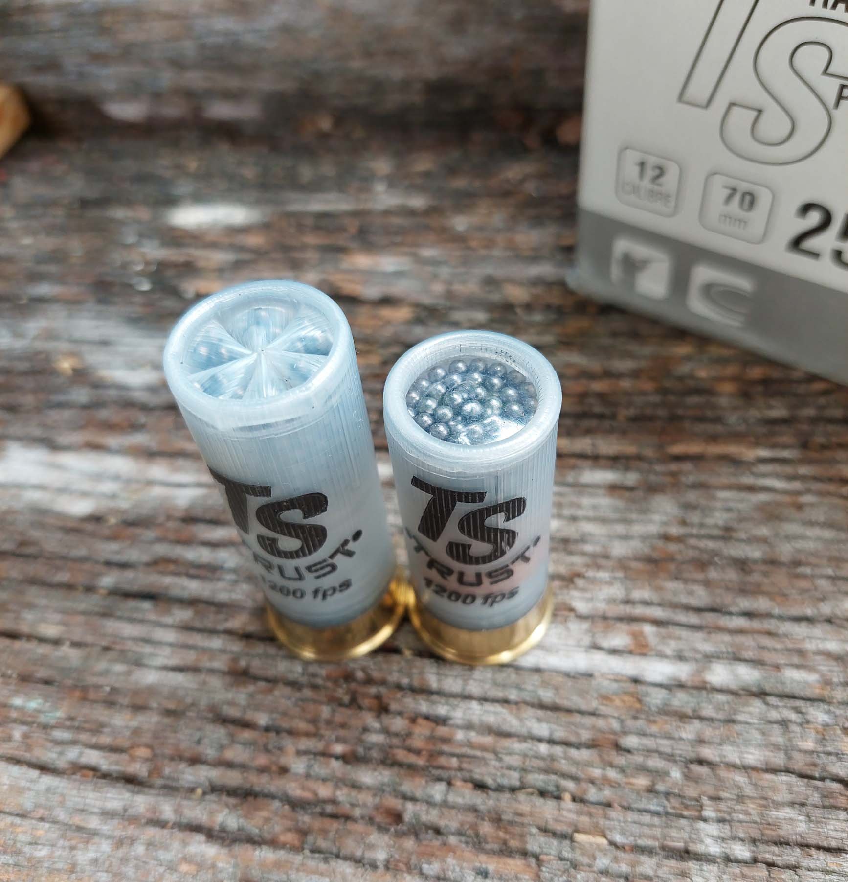

Buckshot Bear Posted October 28, 2021 Author Posted October 28, 2021 Cowboy SS Stoeger (Boito) @Larsen E. Pettifogger, SASS #32933 Larsen, I was going to buy a press to reload shells (really don't want to), but a long term mate of mine has 'remanufactured' a couple of hundred factory shells for me and lightened them a lot and put a roll crimp in the top. My wife likes them a lot better and they still have enough oomph to knock the plates over, mate doesn't mind doing them for me, but I feel its a big ask long term.
Buckshot Bear Posted October 28, 2021 Author Posted October 28, 2021 22 minutes ago, Larsen E. Pettifogger, SASS #32933 said: BB should have asked. What kind of shotgun are we talking about? A cowboy gun or hunting gun? @Larsen E. Pettifogger, SASS #32933 Larson, to add to what I wrote about the shells my mate is doing up for me. He's shortening them, roll crimping and cutting cork wads.

Buckshot Bear Posted October 28, 2021 Author Posted October 28, 2021 1 hour ago, Larsen E. Pettifogger, SASS #32933 said: I asked what kind of shotgun because that directly affects how much stock fitting is going to be done. On a CAS double barrel about all that is done is shorten the stock and add a recoil pad. Much more is not cost effective. Some shot (weight) in the stock bolt hole, a good recoil pad AND light loads is the ticket for most CAS shotgun recoil issues. @Larsen E. Pettifogger, SASS #32933 Larsen would those cut down shells and roll crimps still be legal for CAS?
Buckshot Bear Posted October 28, 2021 Author Posted October 28, 2021 4 minutes ago, Larsen E. Pettifogger, SASS #32933 said: Sure. Thanks mate
Larsen E. Pettifogger, SASS #32933 Posted October 28, 2021 Posted October 28, 2021 Whoever did the shortened roll crimps shells did a nice job.
Buckshot Bear Posted October 28, 2021 Author Posted October 28, 2021 1 minute ago, Larsen E. Pettifogger, SASS #32933 said: Whoever did the shortened roll crimps shells did a nice job. He said it doesn't take him that long to do one and can work through a couple of hundred in no time. He cuts the cork out flooring cork tiles with a wad cutter and hammer. The roll crimp tool he has is pretty neat. I've known him over 20 years, he won't take any money but I know the scotch that he likes.

Buckshot Bear Posted October 28, 2021 Author Posted October 28, 2021 3 hours ago, irish ike, SASS #43615 said: You can buy 12ga. shotgun wads really cheap. Saves the hassle of making your own! You've missed the point mate, these aren't reloaded fired shells there remanfactured unfired shells. Look at the length of the shell....... There's a reason for those cork wads.
