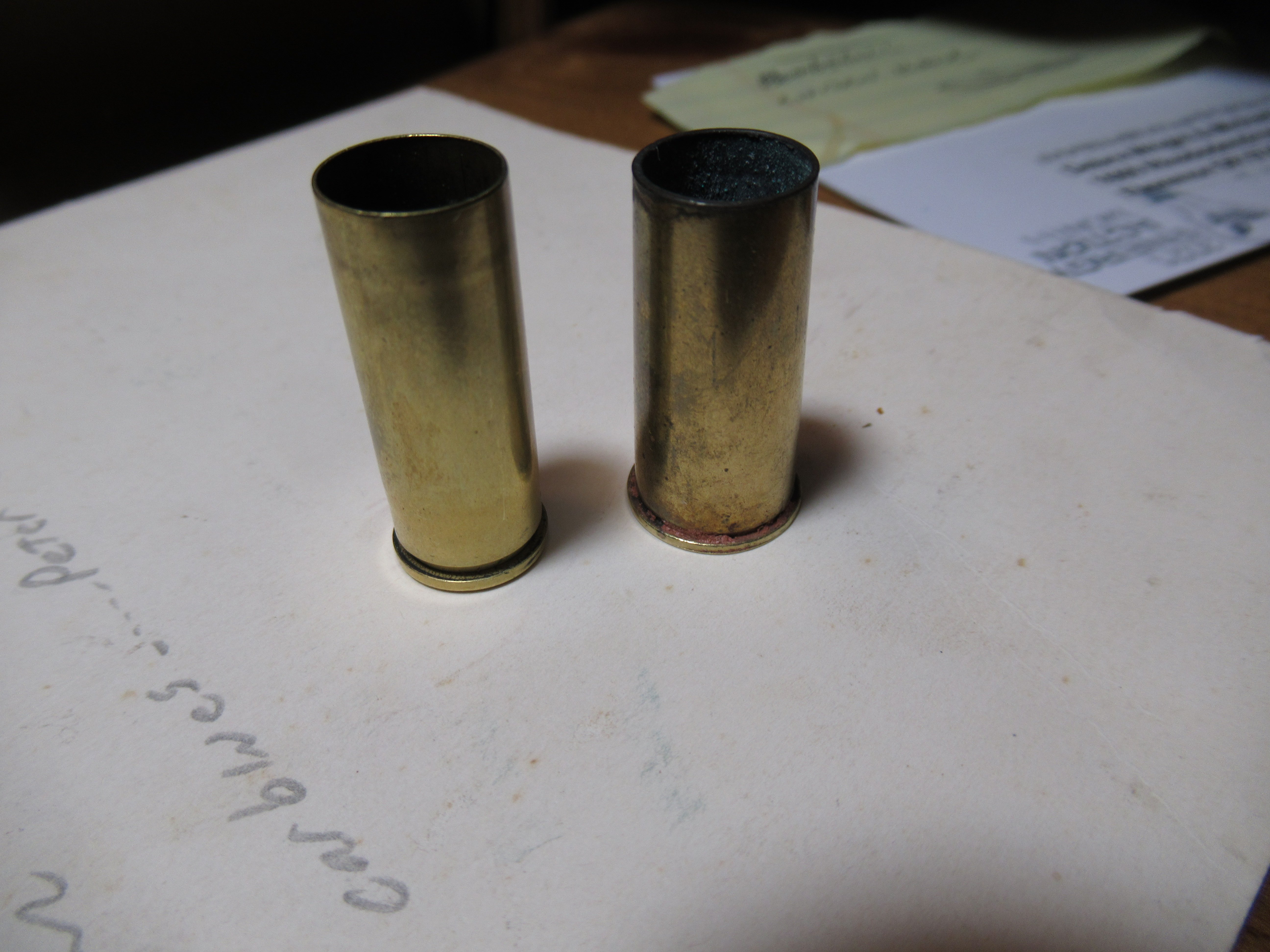

so I found a brass cartridge case...what the heck is it ?
Throckmorton,23149

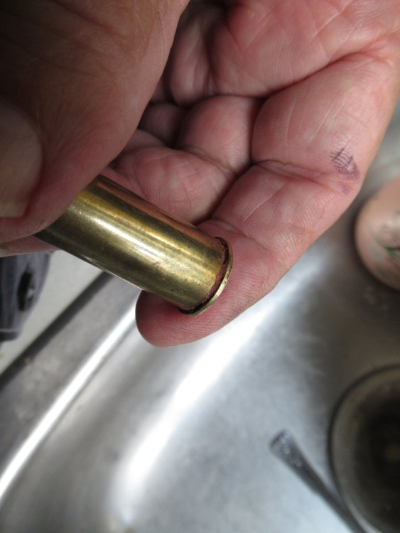

visually it's a fat looking 45 colt case EXCEPT  no extractor groove, it looks to take small primer...I didn't want to actually seat it, but diameter is right.
the main body is tapered, skinnier on top by .030 or so . A .452 bullet fits just right,in the case mouth.

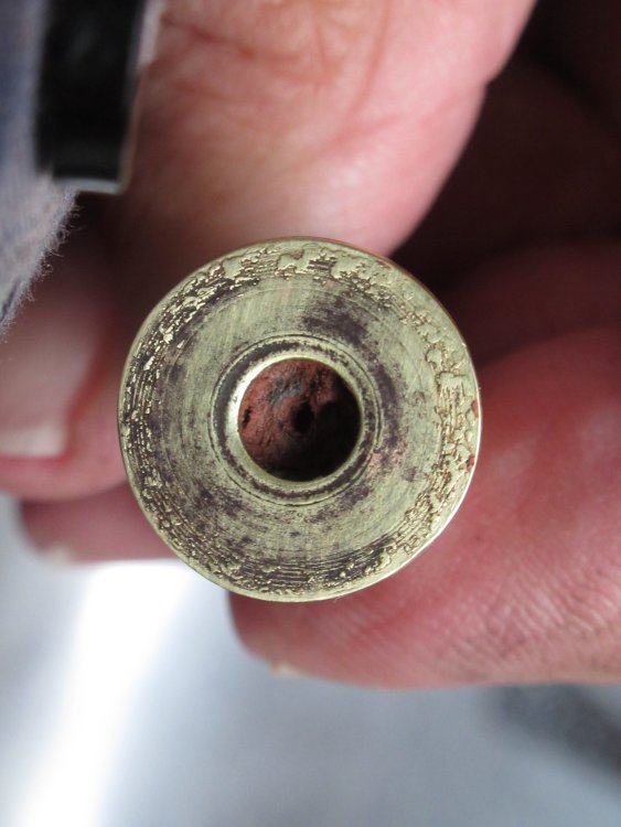

The headstamp looks like gibberish...maybe a pattern of some sort. ?
Just curious what I found lurking, I have no recollection of where it came from
per google all dimensions wrong for schoefield. It's a good 1/8" shorter than a Colt,no extractor groove, rim is several thou. wider than Colt
.45 auto rim ?

oal 1.180, rim dia. 605..case mouth .452... case dia. at base, .544, case dia near mouth, .511
basically it looks like a short ,slightly fatter....thicker brass ?? 45 colt with a bit wider rim taking spp primers

What is the red goop in the primer pocket and on the rim where the extractor groove should be?
No cartridge I know uses 0.030" thick brass at neck. That is not a "design" on head, it is brass spall over concentric-circle stamp/forming marks, (not milling/turning marks).
Cut-down rifle case? Maybe. However, while hard to see the mouth appears at some point had a very heavy crimp.  NO cartridge comes close to matching that head and at-mouth diameter and length, so what die could have done the crimp?
Hard to see, case appears to have heavy black powder fouling.
My guess:  ordinance electric or percussion primer, or artillery fuse igniter.  The .452" inside mouth diameter is pure coincidence, or someone tweeked brass after being fired.

From the measurements given I would guess that it is an obsolete 8mm Lebel round cut down.  The primer pocket looks to have been swaged to hold the primer in.  WW1 machine guns, such as the Vickers, used the Lebel rounds. I could not match up any other rounds to fit.  It looks like the red stuff is in the primer pocket as well as the base next to the rim, possible dirt left from a dug up?

The thing I notice is the rim diameter as stated by the OP at .605. What other cartridge other than .45 government (.608) has a rim that big?
I also don’t think we’re looking at head stamp. Looks more like a case that was spun against an abrasive surface without lube.
