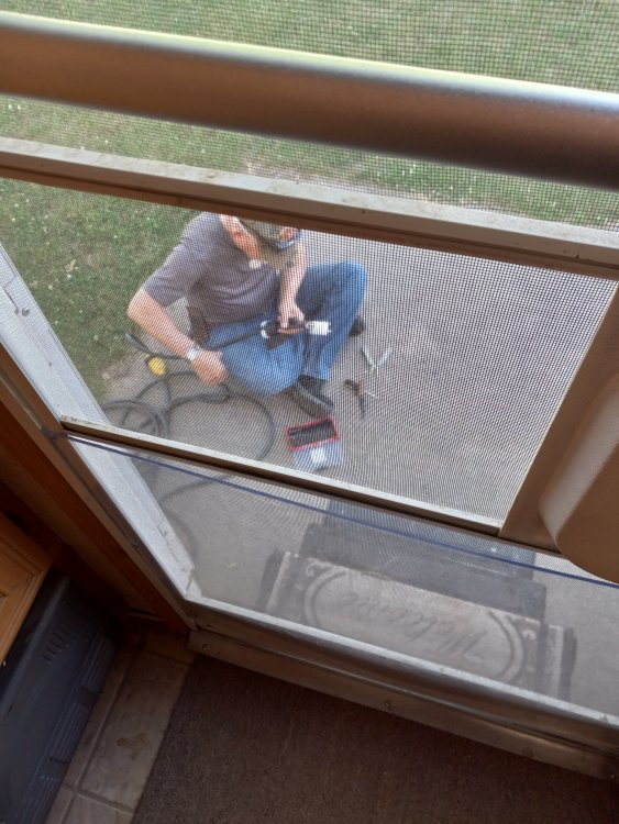

Singin' Sue 71615 Posted June 19, 2021 Posted June 19, 2021 When you sit down to a cool rig...after a long day, and notice "Hey...the fan isn't going." " Did you turn off the fan?" " No, you must have." "Uhm...no. I like it to circulate the air." "Hmmm...is the air even on?" So, outside he goes...breaker kicked at box. Breaker flips real quick again... Go to a second box...nada. Voltometer comes out, and cord is not working. Unplug cord from 5th wheel, and count our blessing there was no fire!!!

Cypress Sun Posted June 19, 2021 Posted June 19, 2021 Also check the male cord end. Rarely is only one of the cord ends burnt/overheated. When you go to buy/replace the cord end(s), the L5-30 is the NEMA number. This is the configuration of the cord ends
Singin' Sue 71615 Posted June 19, 2021 Author Posted June 19, 2021 Just now, Cypress Sun said: Also check the male cord end. Rarely is only one of the cord ends burnt/overheated. When you go to buy/replace the cord end(s), the L5-30 is the NEMA number. This is the configuration of the cord ends Thanks. Shanley works in the electricity field...fixed the one on the small camper.

Snakebite Posted June 19, 2021 Posted June 19, 2021 From looking at the photo, it looks to me like the wire connection was loose. This will cause a hot spot when a lot of current is drawn, such as an AC unit. I would want a #10 or larger wire size for that 30 amp service. Remember, wire size gets bigger as the number gets smaller. I.e., #10 is larger than #12, etc.
Singin' Sue 71615 Posted June 19, 2021 Author Posted June 19, 2021 19 minutes ago, Snakebite said: From looking at the photo, it looks to me like the wire connection was loose. This will cause a hot spot when a lot of current is drawn, such as an AC unit. I would want a #10 or larger wire size for that 30 amp service. Remember, wire size gets bigger as the number gets smaller. I.e., #10 is larger than #12, etc. Yup. In the electric field...well versed on the fix. Just happy this small town had anything to make the repair!!!
Singin' Sue 71615 Posted June 19, 2021 Author Posted June 19, 2021 21 minutes ago, Snakebite said: From looking at the photo, it looks to me like the wire connection was loose. This will cause a hot spot when a lot of current is drawn, such as an AC unit. I would want a #10 or larger wire size for that 30 amp service. Remember, wire size gets bigger as the number gets smaller. I.e., #10 is larger than #12, etc. We should have changed it out last year...as it was aging out...just seem to only remember those things when they fail.
Singin' Sue 71615 Posted June 19, 2021 Author Posted June 19, 2021 The Shanley Hotel is back up and cooling!!! The trailer side tested out dandy...new plug head on and working great. Seems even a bit more 'push' to the power!!! Headed over to Davenport after the services to get a new cord...and will designate the repair as a back up!
