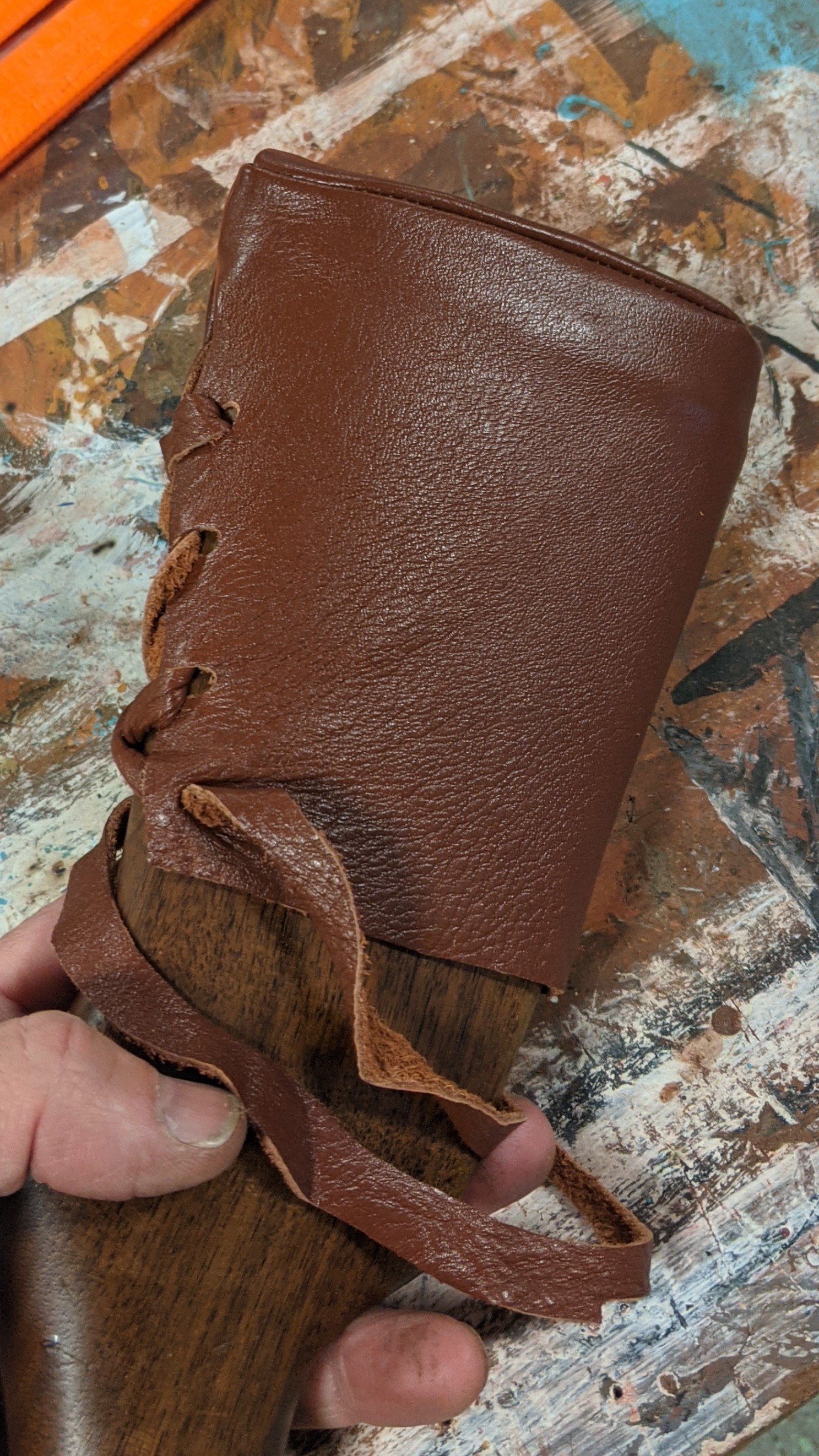

Fretless 54 Posted January 6 Author Share Posted January 6 First of all, thank you all. This thread was extremely helpful. Here's what I did: On Monday, after reading and measuring, I made a conservative cut decreasing the LOP to 12". We kept the angle the same and preserved the curve of the original butt plate. I also sewed a leather sleeve for a 4" long solid steel rod to be inserted inside the stock. Monday night we read more, watched some videos, did more measuring, and decided on a plan. Tuesday, I made a second cut. The finished length of pull is 11 5/8". We still preserved the curve, but changed the angle by 5 degrees. We also abandoned the original butt plate and made a cushion from 6 layers of 1/8" closed cell foam attached to each other with spray adhesive. I put it all together and made a leather cover to dress up my handiwork. The last picture is Fox Creek Stitcher checking the fit. 3 Quote Link to post Share on other sites
DeaconKC 1,312 Posted January 6 Share Posted January 6 That turned out really nice, well done! 1 Quote Link to post Share on other sites
