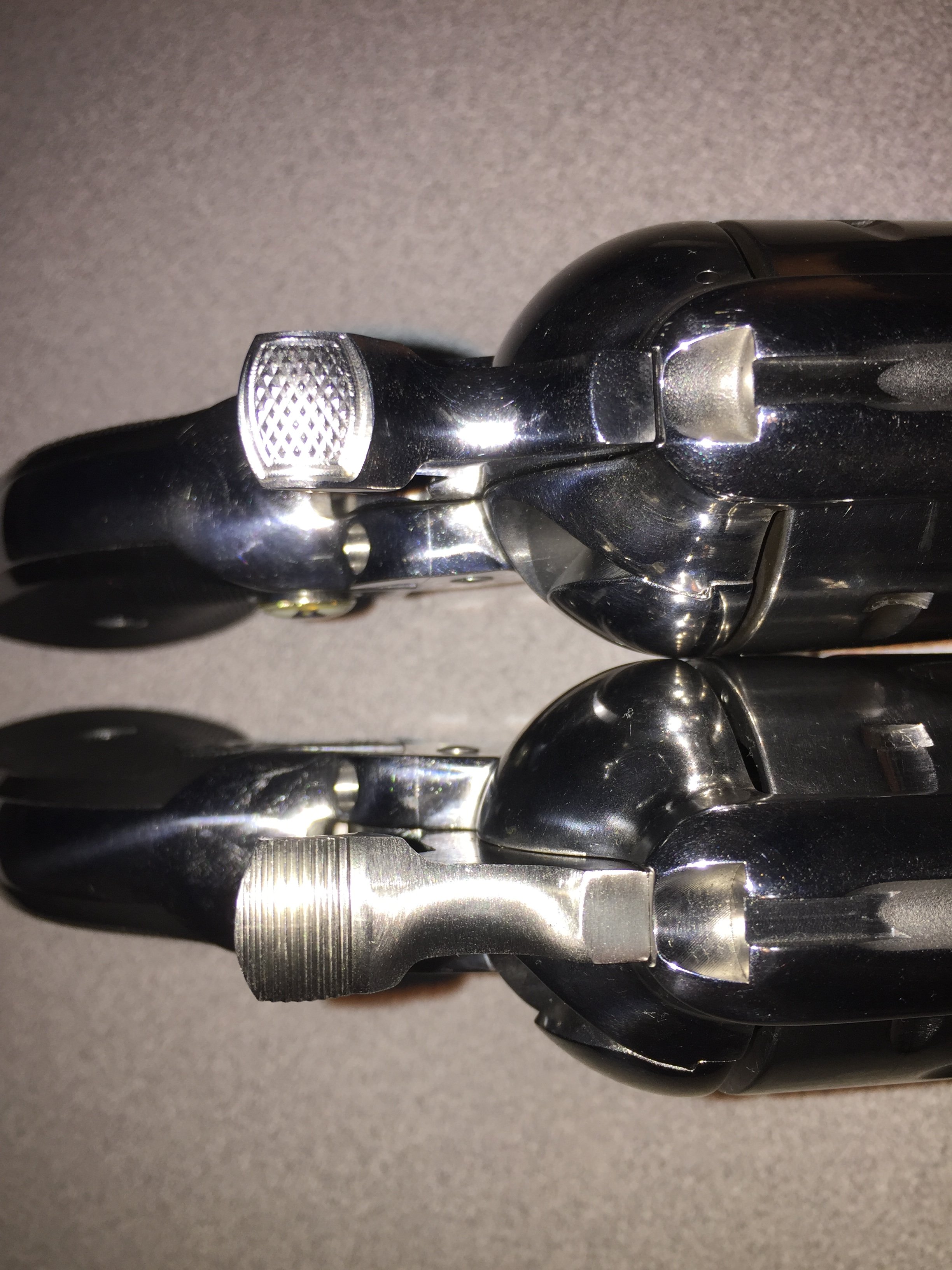

On 8/9/2020 at 5:38 AM, Bingo Montana said:
Montado on the top, SBH on the bottom.
The SBH hammer can be installed without any modifications, it will function as it's supposed to, but it does not "fit". The SBH hammer will not fill the gap between the ears. The New Vaquero hammer is bigger than the BH and SBH hammer in that dimension. A New Vaquero hammer, either one, cannot be installed in a BH or SBH without some grinding in that area. It may be semantics, but that gap is not a "fit".
I installed a New Vaquero hammer into my BH, it took some "fitting" before installation was possible.
From left to right; NV hammer, BH hammer, SBH hammer.
FWIW: the Bisley hammer is even larger in that area.
I've attempted to keep the L to R consistent, Ruger BH hammer, Ruger New Vaquero Hammer, Ruger Super Blackhawk hammer, New Vaquero SASS (Montado) hammer. In the rounded area the New Vaquero is app. 0.040" larger in radius than the BH and SBH hammers.
