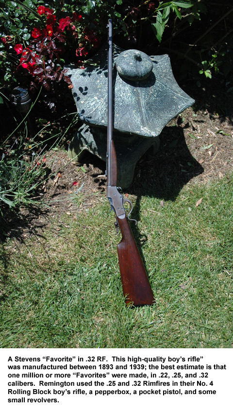

My first thought is that it's a single shot shotgun looking at the thickness of the hammer and breech.  I'm sure others with more experience will chime in.  Ciao
I was wrong.
Don't thing it is a Rolling Block. The trigger guard is wrong.
Its one of the Steven's Favorite models. Hard to tell which one.
You are correct on the Rolling Block, did not notice the tail on the trigger guard.
Stevens and Paige Lewis do have the trigger guard tails.
With no more than just a guess, I agree with SD.   The Stevens 'Favorite' would be my guess.
..........Widder
A Stevens, I think, or a Hopkins and Allen.  The front end of the receiver on a Paige Lewis ends below the rear of the barrel.  The Stevens and H&a receivers enclose the rear end of the barrel.
16 minutes ago, Colorado Coffinmaker said:
Honestly younz.  I don't have a clue.  Honestly.
Me neither - but we have a lot of folks here that do.
Is a rifle with a barrel sight, not a shotgun.  The action is a falling block activated by the finger lever - excludes being a Remington.
The high action cut shape and the perch belly stock and forearm  shape indicate the rifle being a JM Marlin Ballard with about a #3 heavy octagon barrel.  Am I positive? No .....
Based on the curve on the back of the block and the shape of the trigger guard/lever it looks like a Stevens Favorite.  The small barrel size would argue for it being a .22 but it could be a model 44, which was a slightly larger version for small game center fire cartridges.  Here is a picture of my son’s Model 1894 .22 Favorite at the same angle for comparison.
Doc-  I blew it, it is not Ballard ! :angry:
You are on the money: a Stevens has a tang connecting to the action which this rifle has. A Ballard has a bolt through the stock connecting to the action
Proof positive would be if we could see the bottom of the action and if there was the ring or turn bolt (model dependent) to disconnect the barrel. Ballards are threaded screw on barrels
The action is definitely a Stevens and it looks like there is a visible takedown screw. It is most probably a Stevens Favorite.
