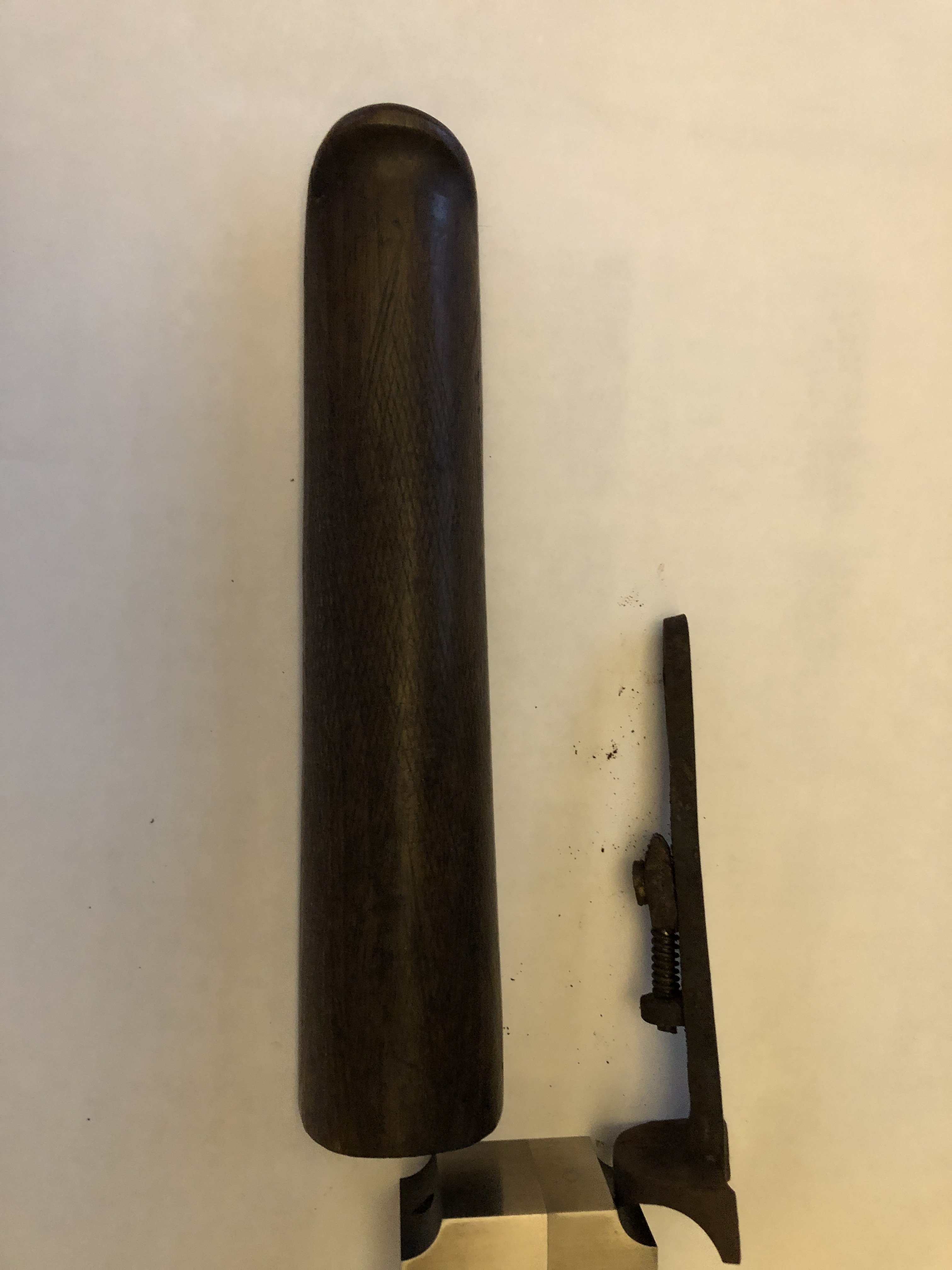

J.S. Sooner, SASS #73526 Posted April 28, 2020 Posted April 28, 2020 I have this old forearm that looks similar, was with parts from a Belgium shotgun marked "A. Richard". I can measure it if you think it may work. Price is right, just cover the shipping.
Tequila Shooter Posted April 28, 2020 Author Posted April 28, 2020 6 hours ago, J.S. Sooner, SASS #73526 said: I have this old forearm that looks similar, was with parts from a Belgium shotgun marked "A. Richard". I can measure it if you think it may work. Price is right, just cover the shipping. thanks JS, I emailed him at 0330 hrs with the post. I'll follow up with him and let you know. Thanks for being a good Pard.
