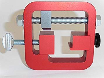

I've got a couple.  Below is a picture of the one i get the most use out of...it's made for Glocks, but will work on other guns as well.
The big benefit is for guys installing night sights that contain a capsule for the glow stuff (love tech terms)   They can break if you try to tap them in.  And the ability nudge the sight slightly.        GW
