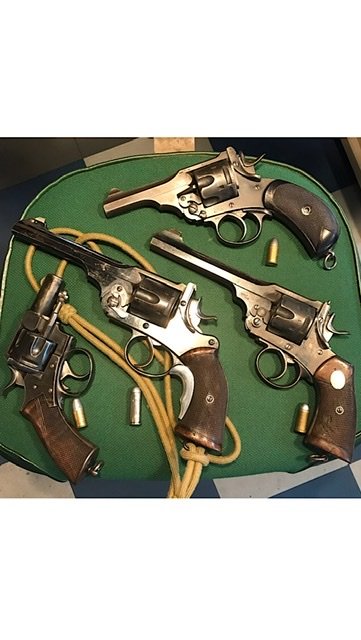

Baltimore Ed Posted December 4, 2019 Posted December 4, 2019 I load .454s in .45lc brass for my caliber altered WW1 and WW2 martial .455 British caliber Colts, Smiths and Webleys. They reload fine and are a necessity for the .455 caliber. Great old revolvers. You might notice a little more recoil but they’ll swage down ok.
