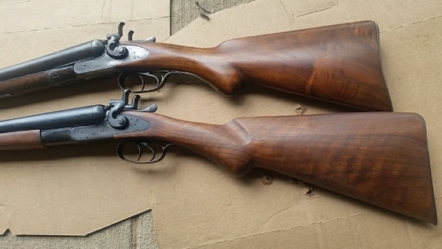

Warden Callaway Posted May 21, 2019 Posted May 21, 2019 The Cimarron 1878 (commonly called the TTN) is a crude copy of the Colt 1878. Here pictured with an original Colt. The CZ-USA is not a reproduction of a Colt TTN. It's just a classic hammer double. It's the one gun I shoot right out of the box. All it needed was limbering up by opening and closing a few hundred times and shooting it some.
