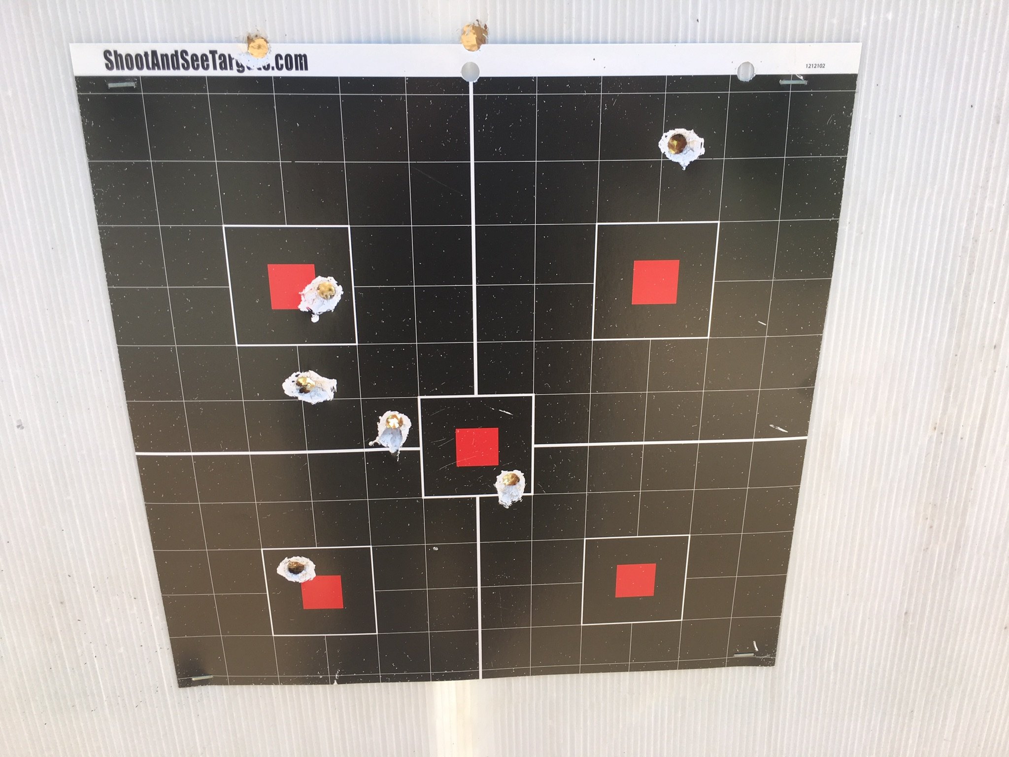

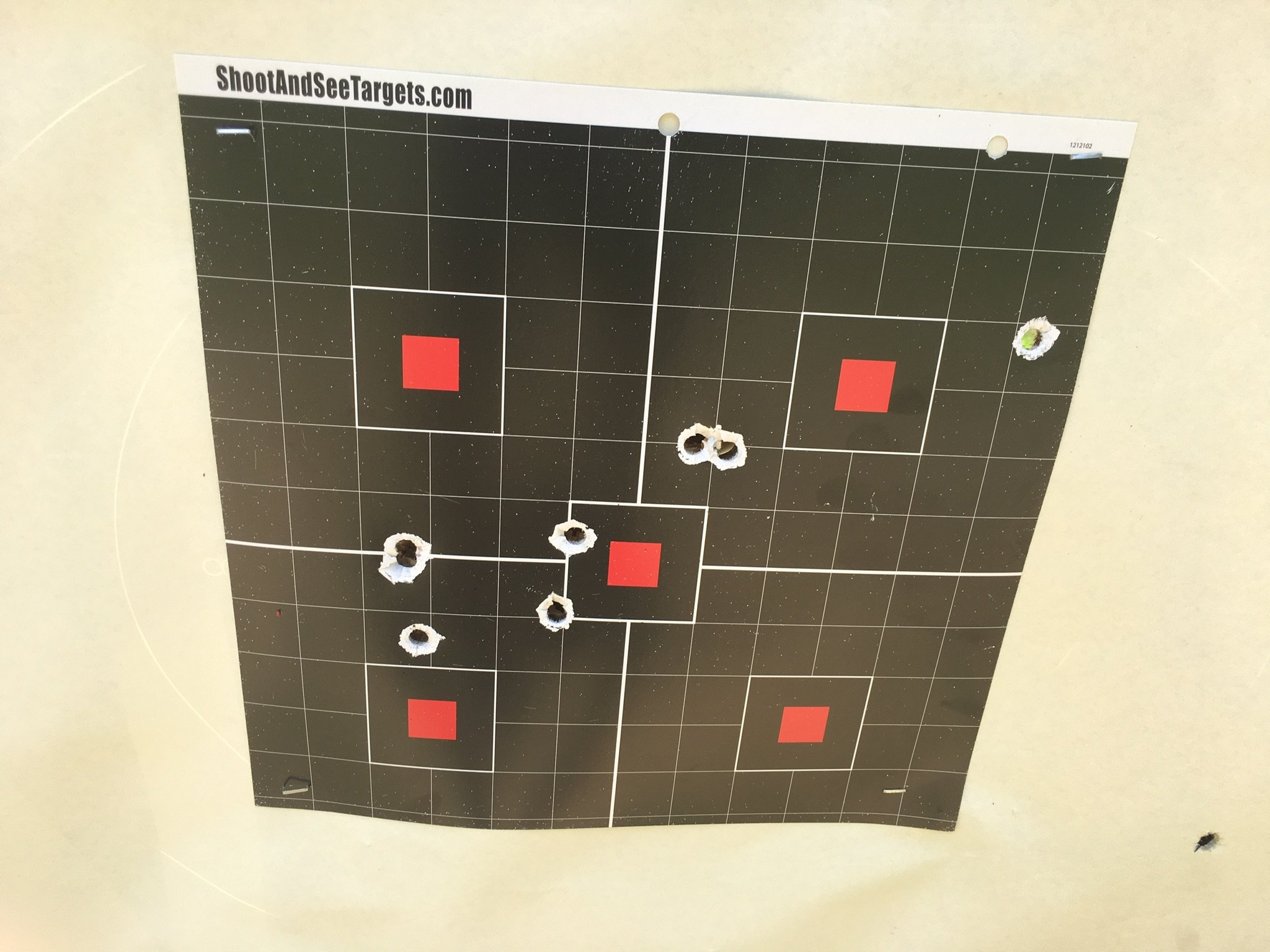

Eyesa Horg Posted October 3, 2018 Author Posted October 3, 2018 Well, I tried my 10 cartridges today with 34.4 gns. of 3031. It grouped off hand at just over an inch at 50 yards. Pretty good I think for me! However, there seemed to be a lot of unburned powder in the barrel. Velocity ran about 1350- 1375. Lost most of my velocity records due to having the chrono too close to the muzzle and the blast deleted the string! That was different! One of these threads indicated not to crimp for a single shot rifle, but I think at least a light crimp would help with the unburned powder issue. So fay, so fun! I think I'm in the ballpark charge wise though. Much Obliged for everybody's help here. Eyesa
Garrison Joe, SASS #60708 Posted October 3, 2018 Posted October 3, 2018 A little crimp won't hurt, and will help with burning all the powder. So would a magnum rifle primer. But if you get a 2" 100 yard group from the bench, I would NOT complain a bit. Good luck, GJ
Eyesa Horg Posted October 3, 2018 Author Posted October 3, 2018 51 minutes ago, Garrison Joe, SASS #60708 said: A little crimp won't hurt, and will help with burning all the powder. So would a magnum rifle primer. But if you get a 2" 100 yard group from the bench, I would NOT complain a bit. Good luck, GJ Thanks GJ. I do have some magnum federal primers and will try them as well.
