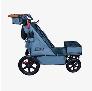

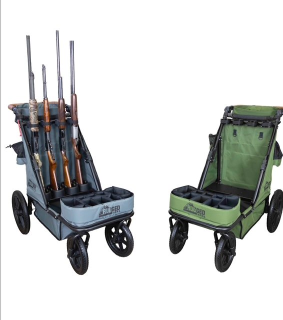

4 wheel Rugged Gear Cart is available!
Scarlett replied to The Original Lumpy Gritz's topic in SASS Wire
These are completely different front wheels that spin on their own and remove easily for storage or travel. And, they are considerably smaller. PARTS for the three wheel carts ARE AVAILABLE! There is NO plan to discontinue parts. Some of the really old carts don’t have parts available.. but the carts that fold with the joint in the middle of the frame (not the screw) will have parts availability! Hugs! Scarlett -
Texas Maverick replied to The Original Lumpy Gritz's topic in SASS Wire
Gonna need a whole lot more than 10% discount with a retail of $1400. I will stay with my old 3 wheel 4 gun deluxe cart for as long as it lasts. TM -
Youngson replied to The Original Lumpy Gritz's topic in SASS Wire
Scarlett, Are the new front wheels the same as the old single front wheel? Or are they smaller? Hope they are the same for future parts availability. Youngson - Today
