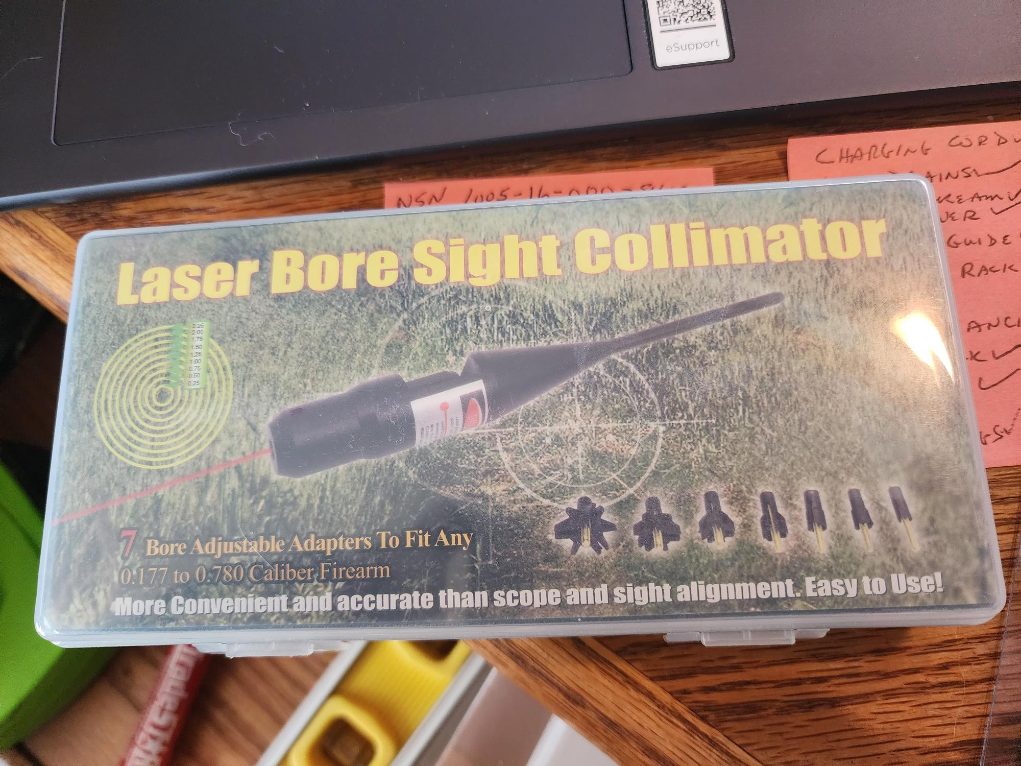

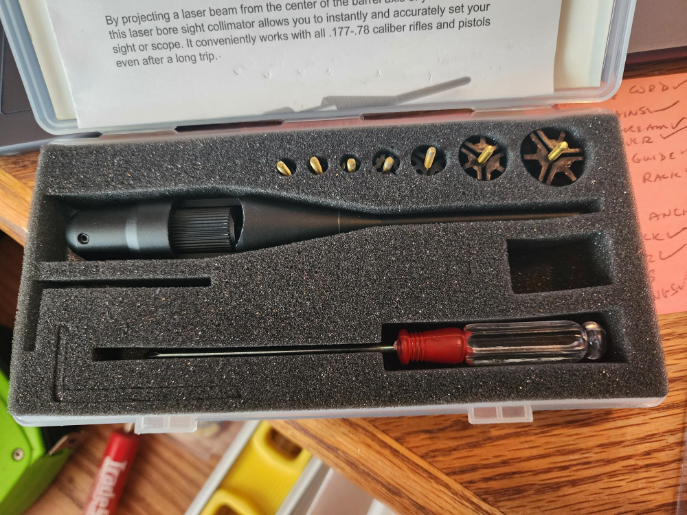

Bore Sighting
Garrison Joe, SASS #60708 replied to Capt Stephen D Hill, SASS #56151's topic in SASS Wire
I don't use a boresighter light. I (like many others) just use the "sight down the bore" approach. Get some sandbags or other rest. But, I've not seen a reason to even do that with SASS MATCH guns. No need to get within 1/4 MOA of the aim point. And, with iron sights, you really have to SHOOT the gun anyway. It's not like sighting in a scope where you can twist a couple of knobs and get the crosshairs onto the laser dot. I did barrel-boresight once (yes, through the .45 caliber hole) a Winchester clone High Wall just to get my tang sight close to POI, though. That probably saved me 3 shots. Ho-hum! 😃 GJ -

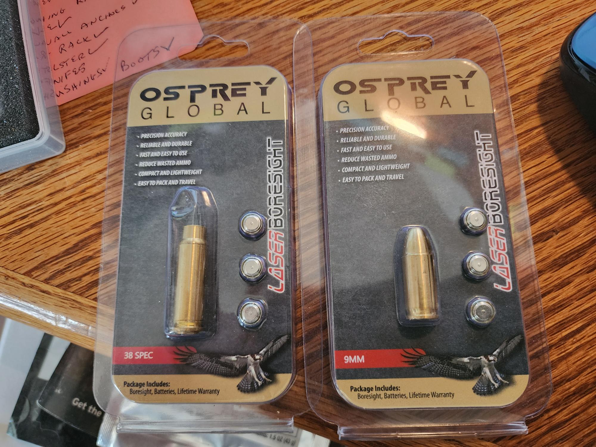

I use one very similar to the one Horace posted about but it is smaller. I used it with pretty good success but then went to using the individual bullet sighter and it is even better for my pistols. I have the 38 and 9mm. TM
