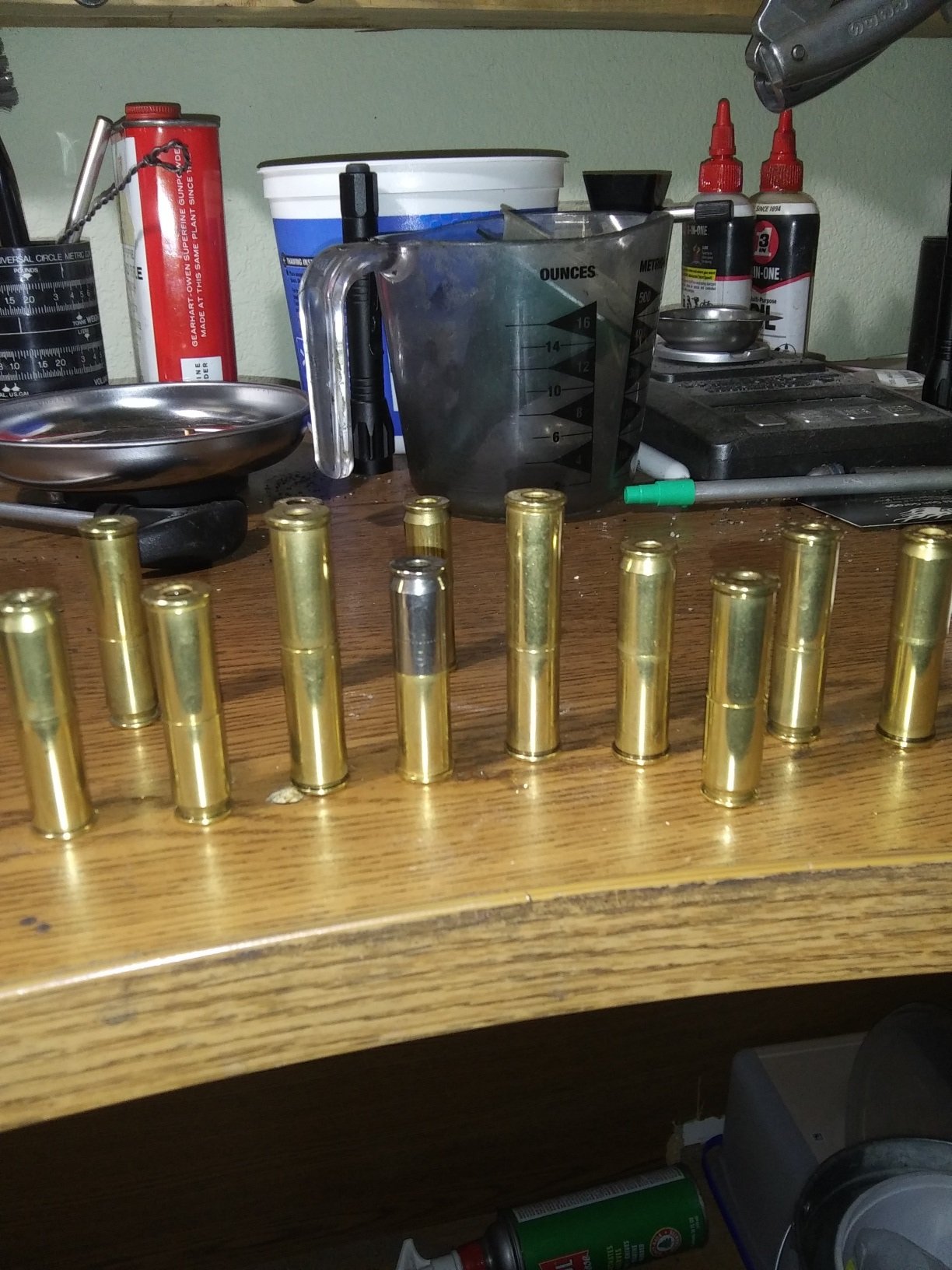

Fallon Kid Posted April 18, 2024 Posted April 18, 2024 I just pulled a batch out of wet tumbler. I had 45 colt / 45 acp and 30 cases of 44-40. I did not think a problem because the case tolerances are so tight it would be extremely unlikely that cases would interfere with each other. (Deep Breath here) Well………...28 of the 44-40 cases ended up in a mixed marriage. Will jot down another reason 44-40 is bad for mental health. LOL

Uriah, SASS # 53822 Posted April 18, 2024 Posted April 18, 2024 Once in a while, I get an unforeseen 9 mm stuck in a 45 caliber when I’m dry tumbling. I turn my Tumbler on and then hold the 45 case up of against the center stud. In about 10 to 15 seconds, I can pull the 9 mm out easily. Uriah
Scarlett Posted April 18, 2024 Posted April 18, 2024 I shoot 32 HR Mag in my pistols and 38 Spl in my rifle. First time I wet tumbled at a friends house - didn’t occur to me. The 32 fit EXACTLY inside a 38Spl case! I hand sort before I tumble and it does NOT MATTER… I always miss one or two. Hugs! Scarlett

DeaconKC Posted April 19, 2024 Posted April 19, 2024 Okay, when you get a stuck case inside another, grab your handy dandy ACME kinetic bullet pullet, yeah the old hammer type, and smack it a couple times. It will pop right out.
Fallon Kid Posted April 19, 2024 Author Posted April 19, 2024 Not gonna fall for that again…. So anyway. I sorted brass (44-40 45 colt acp) and I can’t account for one 44-40 brass. I have sorted 3x’s so started doing the only thing I know to do. Hand load the 45 colt w/ black powder and will find during expanding. (Gosh having to hand load on a Thursday night! LOL) I could not be happier. Indecently, I found (2) 45 colt brass with small primer going through sorting so maybe a good thing. I found one sml primer 45 colt about a year ago and now two?

Griff Posted April 21, 2024 Posted April 21, 2024 On 4/18/2024 at 1:05 PM, Fallon Kid said: I just pulled a batch out of wet tumbler. I had 45 colt / 45 acp and 30 cases of 44-40. I did not think a problem because the case tolerances are so tight it would be extremely unlikely that cases would interfere with each other. (Deep Breath here) Well………...28 of the 44-40 cases ended up in a mixed marriage. Will jot down another reason 44-40 is bad for mental health. LOL Some things one just SHOULDN'T confess in public! Mixed marriages indeed! A truly unholy union is a 38 Special backed rim first into a 45 when dry media cleaning... talk about wedgies!
