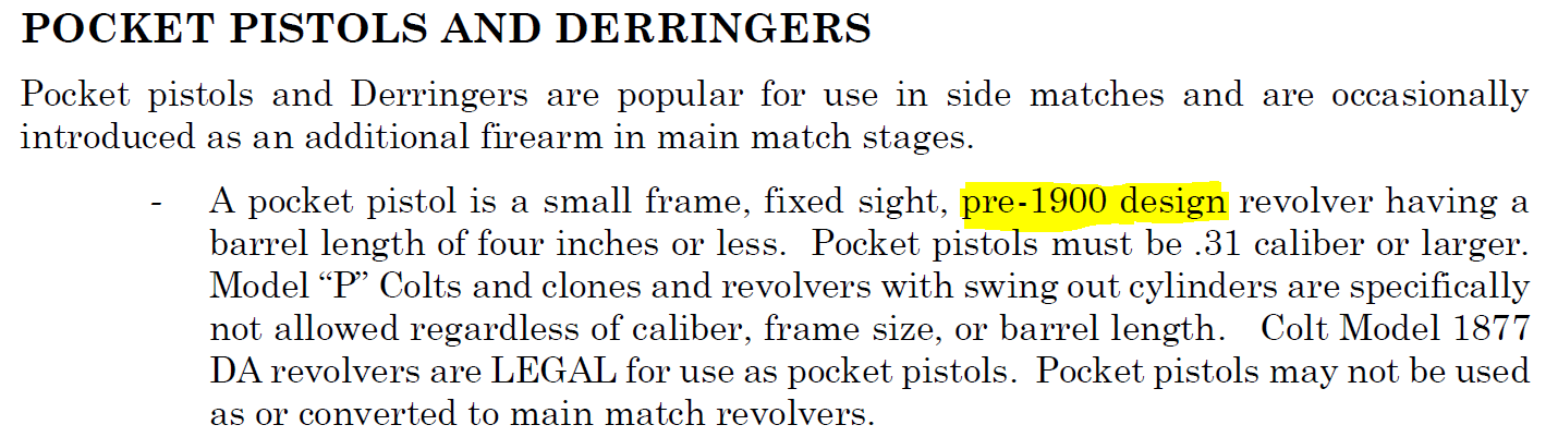

SASS rules state barrel can be no longer than 4 inches. I think 38 S&W is best. Do not be concerned about patina of the metal or finish of the wood. Concentrate solely on mechanical soundness. Don’t buy one that you cannot shoot first. Don’t pass up a really good Iver Johnson.

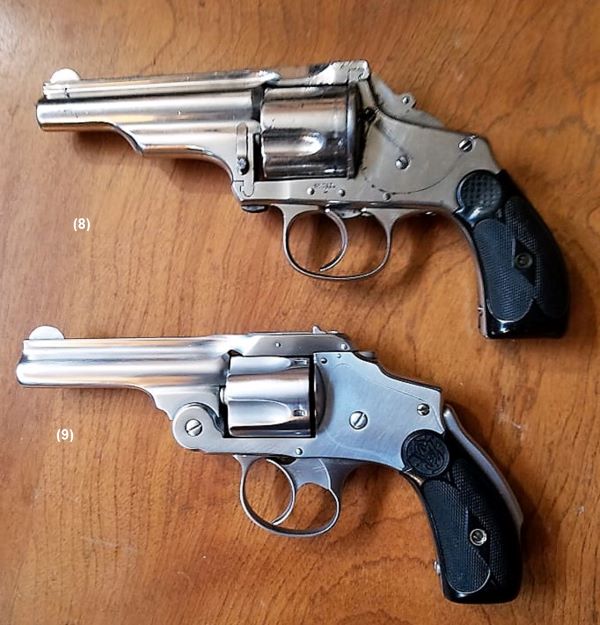

Lemon squeezer is a another name for the S&W double action, hammerless pocket pistols with a grip safety. Hence the name Lemon squeezer. If it does not have a grip safety, it is not a lemon squeezer.
The Smith and Wesson Perfected models were mentioned. Lacking a grip safety, they are not lemon squeezers. These are the Top Break 38 S&W pocket pistols that have a latch on the top AND a sliding thumb piece on the side of the frame. In order to open them, BOTH the thumb piece and the latch have to activated at the same time. They are nice little revolvers, made of modern steel, capable of firing ammunition loaded with Smokeless powder. But technically they do not qualify as a SASS pocket pistol because they were made from 1909 until 1920. Don't tell anybody but I did use one in a Pocket Pistol match a number of years ago.
pnBDmvQAj
Most of the other S&W Pocket Pistols should only be fired with Black Powder because most were made with steels that were only suitable for Black Powder. Notice I said most, not all. Some were made into the 20th Century, but as such they would really not be legal for CAS Pocket Pistil matches. I am not going to go right here into all the variations, but there were a bunch of different S&W safety hammerless pocket pistol models that were made into the 20th Century. both 32 S&W and 38 S&W.
Iver Johnsons are interesting. Around 1900 Iver Johnson completely redesigned their revolvers for Smokeless powder. They used batter steel than was being used in the earlier models. Notice the lack of a grip safety, so this Iver Johnson safety hammerless is technically not a lemon squeezer.
There are three characteristics that indicate whether or not an Iver Johnson is a Smokeless gun or a Black Powder gun.
This one is a Smokeless gun. Notice the direction the little owl on the grip is facing, backwards. If you remove the grips you will find the hammer spring is a coil spring. And study the shape of the cylinder locking slots. Notice they have a hard edge both top and bottom.
pnYHFfasj
This is a Black Powder Iver Johnson.  The little owl on the grip is facing forward, the hammer spring is a leaf spring, and notice the cylinder locking slots only have one hard edge.
pmONRDk1j
DJ said: "Some were made into the 20th Century, but as such they would really not be legal for CAS Pocket Pistil matches."  Just to be clear, it is my understanding that guns that were "made into the 20th Century" are SASS-legal pocket pistols as long as they are of "a pre-1900 design" and 4" or less barrel, .31 cal or larger, small frame, and fixed sight, and no swing-out cylinder.  The Shooters Handbook (Version 26) doesn't say it has to be manufactured before 1900, only that it must be a "pre-1900 design."  Thus, as I understand it, the H&R Premier is a legal pocket pistol because it was introduced in 1895, even though it was modified in 1905 (and designated Second Model) to shoot smokeless cartridges, and was produced until 1941.  Apart from all of the minor mechanical variations, the basic design of the Premier is "a pre-1900 design" so someone can purchase an H&R Premier Second Model gun made in 1940 and use it for SASS pocket pistol side matches.  (This is no different than the rules for other guns.  For example, a Winchester 97 is SASS-legal even though it may have been manufactured in the 1940s and differs in numerous minor ways from the last Win 1897 actually made before 1900, because the design is basically the same pre-1900 design.)
Take a look again at the S&W Perfecteds that I was talking about. They were made from 1909 until 1920. Not a "pre-1900" design, they were a completely new design in 1909. So don't tell anybody, but I was cheating a little bit when I used one in a pocket pistol match a few years ago.
IMO...the basic design is pre-1900.
The added side latch only affects the opening mechanism.
(This is NOT an "official" ruling) ;)
I bought a Perfected model a couple years ago, but thought it would be disallowed due to the time frame until Palewolf, as above, offered his opinion on another board as to its legality.
How about this 4" Iver Johnson New Model/3rd Model .32 S&W with these original one piece grips? It was manufactured from 1909 to 1941, and, using the same logic as the S&W Perfected model, should be legal as it's the same basic design as the 1st and 2nd models, but the grips extend beyond the grip frame AND cover the backstrap. Would it need different grips to qualify?

I'll print out the relevant photos on this thread to present to the ROC at EoT to see if I can get an "official" ruling on these variations
Submission of an FMC this close to EoT would likely delay any discussion opportunities.

A few years ago, just before I went to EoT, I asked if the pistol was legal.  PaleWolf said it was.
I used it at EoT, and no one said anything about the grips, or the pistol in general.

My understanding is the Perfected model is SASS legal. But in the above picture the one on right certainty looks like barrel is longer than 4” and the center one is likely longer than 4”. The one on left should be ok.
