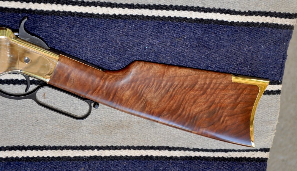

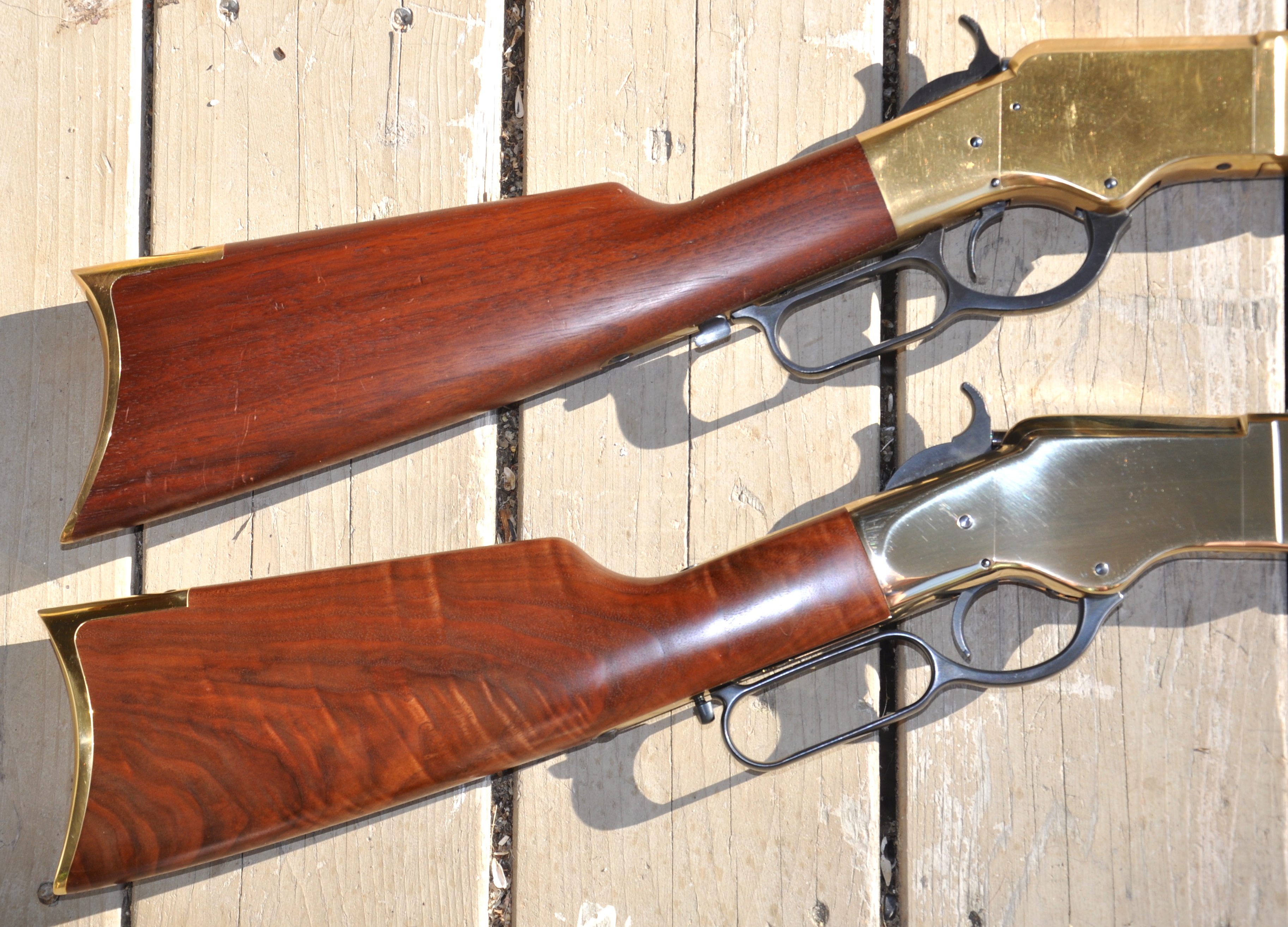

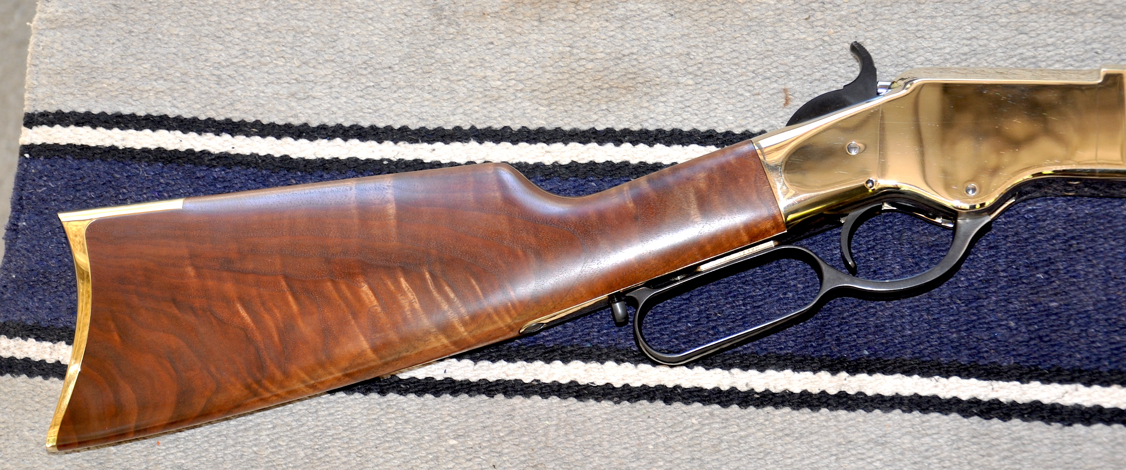

Tuolumne Lawman 6127 Posted October 24, 2022 Posted October 24, 2022 The Henry Repeating Arms "New Original Henry" is a true 1860 design, like the Ubertis. While more expensive than a Uberti, the wood is all figured walnut, deeper bluing, better polished and slicker than snot..... I had an Uberti 1860, and thought it was all Henry hype, UNTIL I got one, WOW! The Uberti is like a Chevy compared to the HRAs being a BMW BTW. The original was just named "Henry Repeating Rifle", in honor of Winchester's Hew Haven Arms plant chief engineer, B Tyler Henry, who patented the design in 1860 (production started in 1861, IIRC). 13,000 were produced, of which about 11,000 + were used in the In the Civil War, where it was called "The Horizontal Shot Tower," "Fifteen shooter" or "That Damn Yankee Rifle you load on Sunday and shoot all week"! It later picked up the 1860 handle to differentiate it from the Model of 1866, the NEW IMPROVED HENRY, or it as it was just called that or Winchester .44 caliber repeating rifle when it came out. (It had other names: "Yellow Boy," "Sixteen Shooter" or "Spirit Rifle of many Voices." ) When the Model of 1873 came out, the early ones began being called either 1860 (Henry) or 1866 (Winchester).
Tuolumne Lawman 6127 Posted October 24, 2022 Posted October 24, 2022 Comparison of Uberti Henry (top) vs HRA Henry (Bottom). Not the finer polishing of the HRA receiver and barrel, as opposed to the Uberti. Last two are the close ups of the HRA figured walnut on their standard version.
