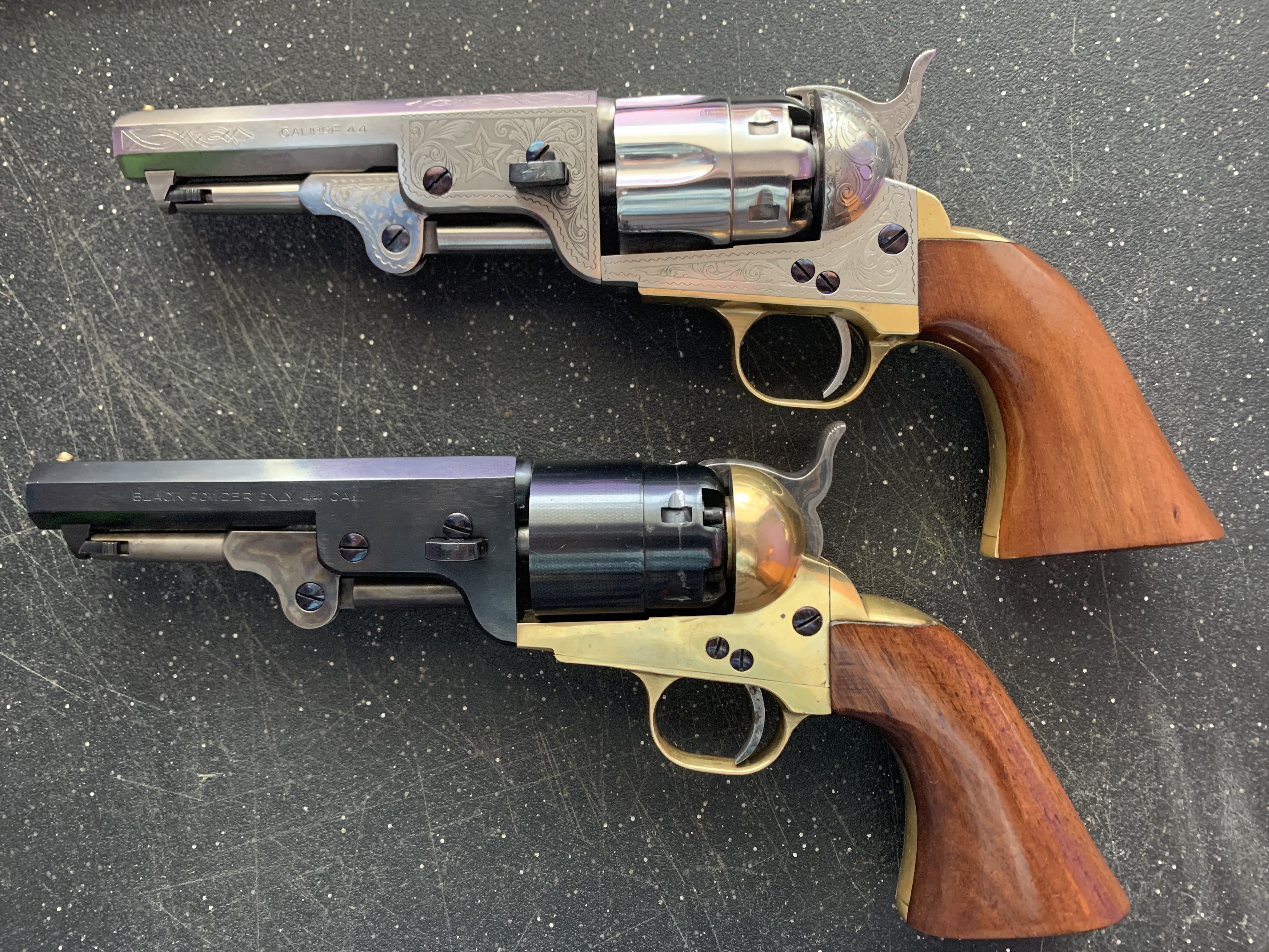

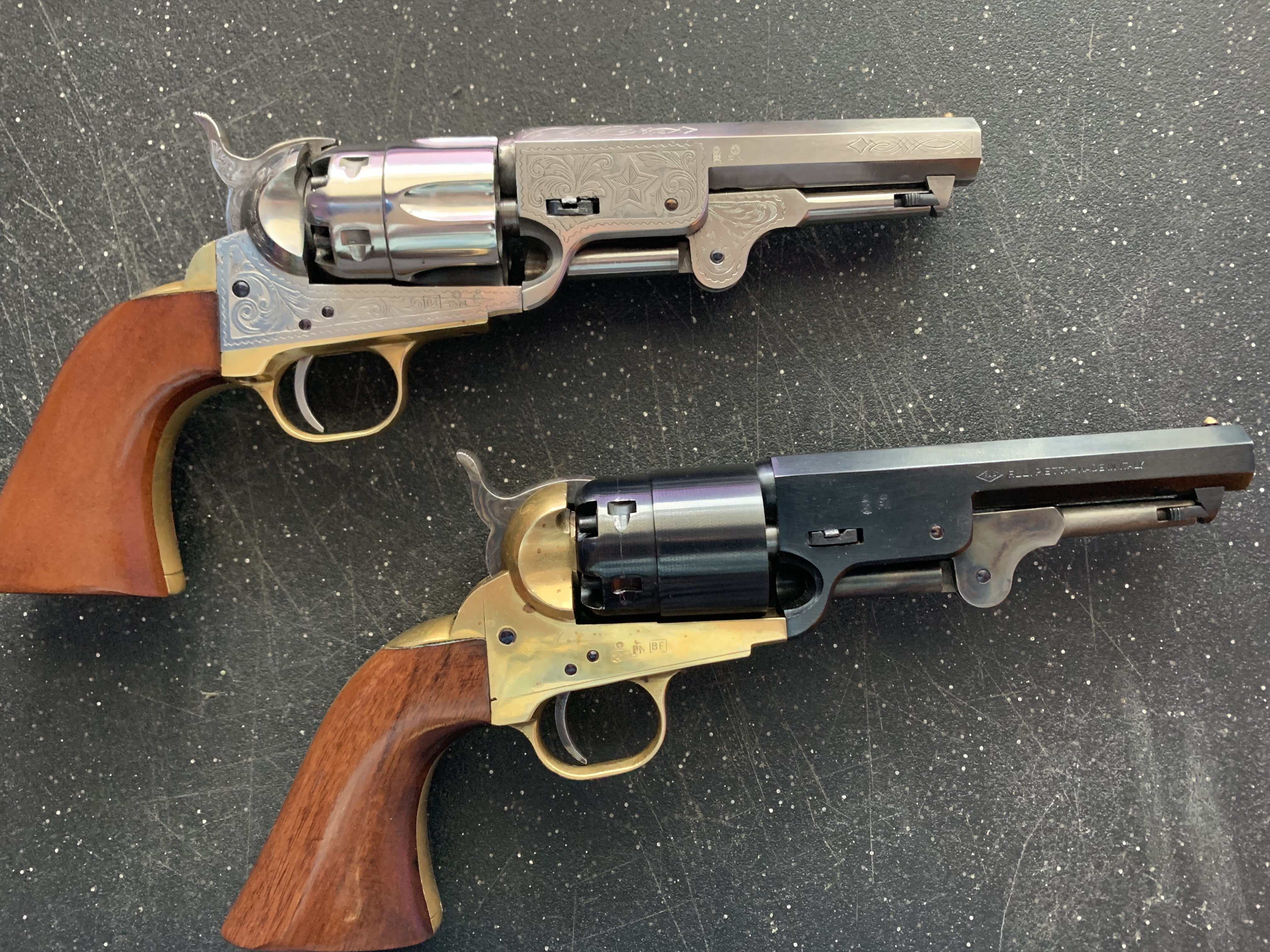

Captain Bill Burt Posted September 17, 2021 Posted September 17, 2021 I got my Pietta 1851 Navys back from Goons Gunworks and I have to say I'm impressed. Mike took the hammer draw from about 8 lbs down to about 4 lbs. He put in cap posts, corrected the arbors, put in a coil spring action, action stop, action shield, corrected the timing and hardened and fire blued the screws. I'm about ready to do some cap and ball shooting.
irish ike, SASS #43615 Posted September 18, 2021 Posted September 18, 2021 Thats a deep notch in the hammer face to reach the cap!

45 Dragoon Posted September 18, 2021 Posted September 18, 2021 2 hours ago, irish ike, SASS #43615 said: Thats a deep notch in the hammer face to reach the cap! The posts look tall from that perspective but the safety slots retain their original size. I fit the posts to the slot to maintain as much hammer face as possible. Mike
