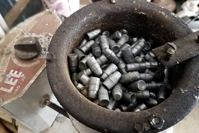

Bullet casting day!  The Lee pot was full of mixed lead for regular bullets.  I just didn't want to run it back out into ingots so I cast up a cake pan full of 200g 45 bullets with my Lee 6 cavity mold.  I cleaned up the pot and dumped in the odd bullets.
Taking a break while the melt.
I just cast up a hundred or so balls. By judging from the stiffness of the sprue strip, I suspect they have some alloy mixed in.
The two on the right are the ones I just cast from the unknown bullets.  They set well in the mouths of the 44 cylinder.  The two on the left are some I've cast from what I believe is pure lead. I don't have a hardness tester. But I have a spring-loaded center punch that should give a consistent blow. As you can see, the mark left on the new balls are significantly smaller than the the known soft balls.
I'll try to load a cylinder or so and see how it goes. If they won't work, in they will go into the general mix.
I loaded a cylinder with the balls that I cast with the odd bullets and they were very hard to press in.  So back in the pot they go to make regular bullets.
Hard balls on the right.
