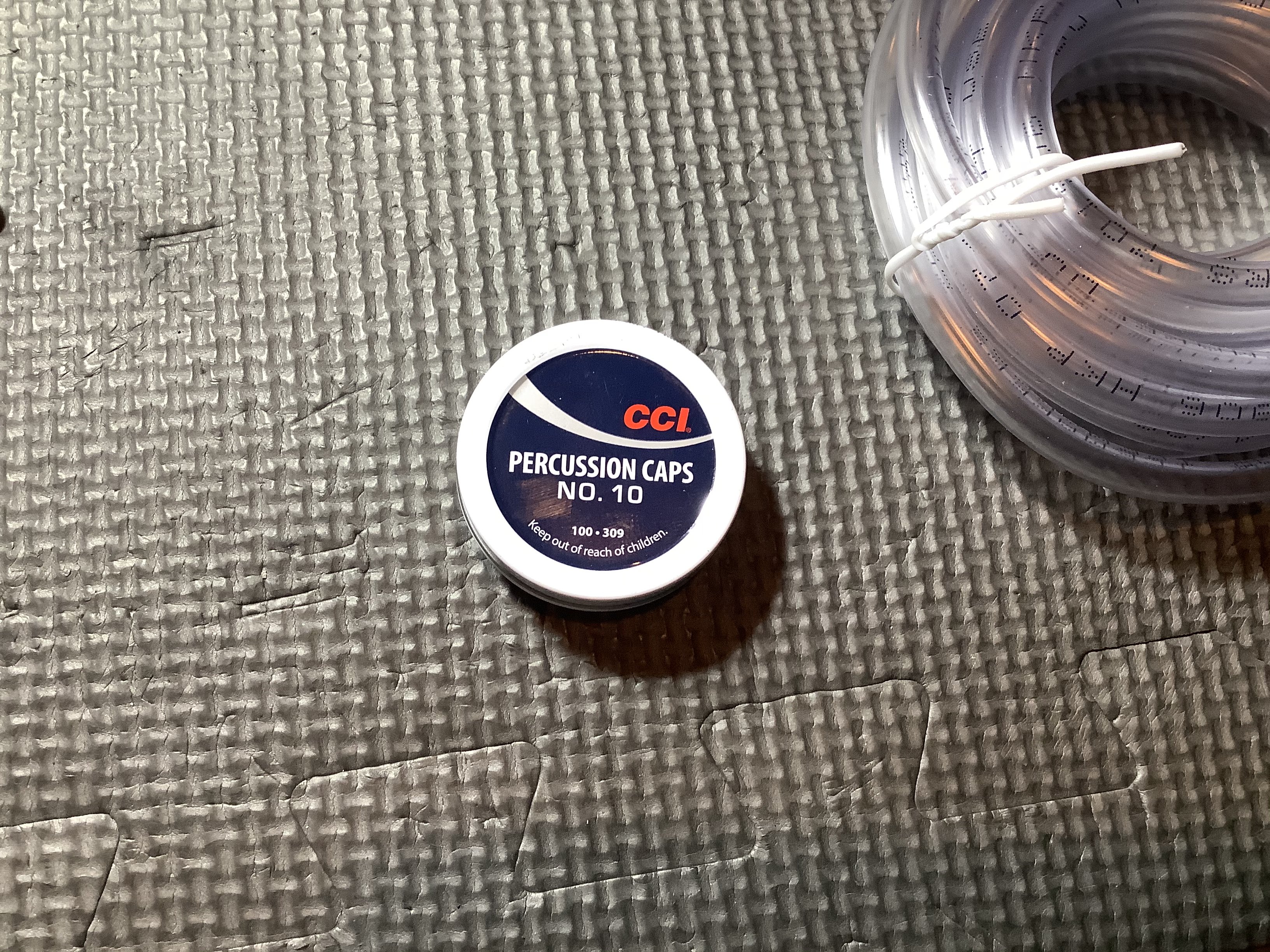

This is a little work, but it gives us c&b guys an option w/ slix nipples and CCI #10s.
1. 1/4” OD clear tubing - cut these w/ dykes to make a cap keeper.  Cheap for 10’ at Home Depot.
2. CCI #10s are 0.005 smaller than Remington #10s.  See Mako’s cap chart.  The tubing keeps the caps on and mitigates the not so ideal fit up to slix nipples.
Interesting thought and idea...First question, they stay on but are there any problems getting the caps to go off?? Have done enough test fires to give a good account to their working???  Any plastic left to clean off??

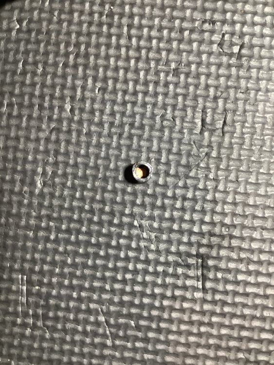

TL,  I did a test on the deck with just caps. They all went pop on the first try. The caps w/ the tubing stayed in place perfectly with a touch of black but not burnt or melted.  No plastic residue left over.   The caps were easily removed with my screw knife.  The unkept caps, being smaller ID, come apart quite nicely and become prime candidates to jam the cylinder.

My experiment with DYI cap keepers didn't work out well.  I made 12 up.  And shot two cylinders.
By the third shot, the gun was jammed.  The first cap ejected out of the keeper.  You can see the next cap just jumped back with keeper.  The cylinder hopelessly jammed on last shot.  I took it in and took it completely apart. Two pieces of cap fell out.  I had completely disassembled and cleaned it after last shooting session so the cap parts must have came off this cylinder full.
One cap on the second cylinder load jumped out of the keeper.
I ran two more cylinders with no keepers and caps busted and fell away.
One thing the two that jumped out of the keeper had was that were shorter than the rest. I noticed when I was slicing them off the tube that I was getting different lengths.  But decided it would be a good test.  Short didn't work. But even the long ones didn't always work. (I did push them on with an antler like I would do.)
The tube I bought was also. 1/4" od. X .017 id.
Warden, ol' buddy, I gave my cap keepers the old college try.  I agree with you.  CCI #10's and make shift cap keepers are a no go.  I tried using some refrigerator water line, 0.25" OD /0.17"ID same as the clear tubing above.  Giant PITA.  Slix nipples are definitely Rem #10 only.   I put 60 balls through one pistol to test.  There were times I went three times around the Ruger.
