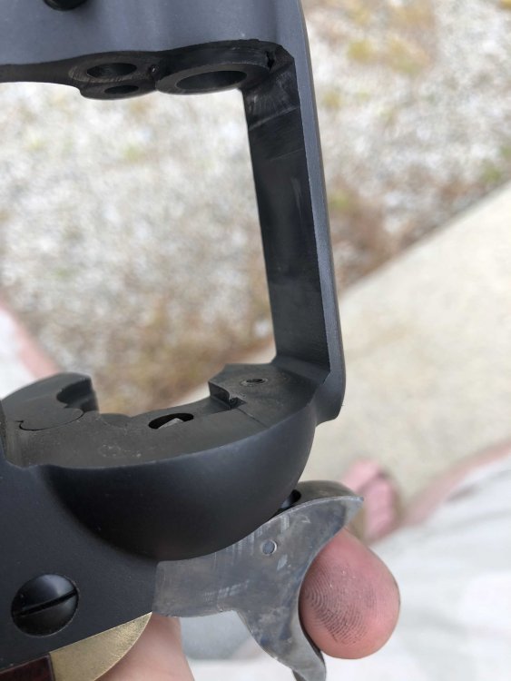

Big Hand Zack Posted May 25, 2020 Posted May 25, 2020 Hello all. Recently picked up my 2nd SASS pistol in a trade, an Uberti Cattleman Hombre in .357. I have been practicing a lot, both dry fire and live shooting. The other day the cylinder started turning a little rough only when loaded. I inspected The firing pin hole and found that the metal on the rim of the hole is getting pushed out slightly making a small berm/burr, which is rubbing on the cases when loaded. The pistol appeared to be barely fired when I got it, and the guy who traded it confirmed he did not fire it much. Only rounds I've put through it are my light .38 loads (125 TC over 3.0gr Titegroup) Is this normal for a lower end single action like this? Not that its lower end but the more value based pistols. Is this as easy as filing down that bur? or is this something I should be contacting Uberti about?

Big Hand Zack Posted May 25, 2020 Author Posted May 25, 2020 19 minutes ago, Warden Callaway said: Waste of time. I have a Uberti made in early 70s that had the same problem. Every Uberti we have has had this happen. I've gotten to add to my clean and inspect routine to feel the area around firing pin hole for burr and hone off any I find. The problem seems to come up less often as time goes on. Thanks for all the replies and help guys. Glad to hear its just normal for these guns. I looked at my most recent brass. Obvious on the primer of the burr, but does seem that the primer strikes are sometimes a little low, which is what I was suspecting after inspection. I'm assuming due to tolerances, and soft metal that these don't mesh perfectly and may require a "break-in" period, quite literally. Heres a pic of the brass. I'll hone down the bur, as well as the polish down the lip on the recoil shield. I'll look in my shop and see if I have some snap caps and just use those. I did order a Wolff spring kit for it as well, the hammer is quite stiff on these. Any other minor at home honing or upgrades I can do?
Tequila Shooter Posted May 25, 2020 Posted May 25, 2020 Just looking at the pictures you posted it looks like the left side of the hammer might need a look, most likely it a bur or two on the frame. Otherwise I'd do a complete strip of the guns and check for burs and file them down. Be very careful if you do anything with the seer or pawl the angle and depth of seer is critical to function. Here's a video to disassemble and re-asessemble a SAA.

Big Hand Zack Posted May 25, 2020 Author Posted May 25, 2020 1 hour ago, Tequila Shooter said: Just looking at the pictures you posted it looks like the left side of the hammer might need a look, most likely it a bur or two on the frame. Otherwise I'd do a complete strip of the guns and check for burs and file them down. Be very careful if you do anything with the seer or pawl the angle and depth of seer is critical to function. Here's a video to disassemble and re-asessemble a SAA. A good idea for sure. Ya the left side of the hammer has some visible scratching. Nothing I can feel but definitely there. thanks

Warden Callaway Posted May 25, 2020 Posted May 25, 2020 1 hour ago, Big Hand Zack said: Whoops... forgot to add the pic of brass... When I look at the primers in your cases, the deformation looks like what I saw in the Smoke Wagons that has a crater around the diring pin hole. When I blow up the picture in your original post, it looks like there is a crater circling the diring pin hole. Clean and inspect this area and see if you have a crater like in the picture below. Here is a picture of one of the ceses. If that's what you find, you're screwed.

Big Hand Zack Posted May 26, 2020 Author Posted May 26, 2020 10 hours ago, Cypress Sam, SASS #10915 said: You can bevel the edges of the firing pin hole by placing a drill bit (Wrapped with masking tape to prevent damaging the rifling) down the bbl. Then hand turn the bit to “countersink” into the frame a little. This will prolong the life of the FP hole before you have to do it again. Don’t use a powered drill for this not even a hand powered one. Turn the bit with your fingers and keep it straight with the barrel. Thats a good Idea.. I may try that just a tad. wouldn't need much, nor would I want much of a counter sink, but in this case, just a little bit would help I'm sure. I'm also hoping that this was a little bit of a "break in", and the next time shouldn't happen so quickly, and not to such a high degree. 8 hours ago, Warden Callaway said: When I look at the primers in your cases, the deformation looks like what I saw in the Smoke Wagons that has a crater around the diring pin hole. When I blow up the picture in your original post, it looks like there is a crater circling the diring pin hole. Clean and inspect this area and see if you have a crater like in the picture below. Here is a picture of one of the ceses. If that's what you find, you're screwed. This is not what I found. the indent was INTO the primer, not the other way around. When the firing pin hole pushed metal towards the case, it made a hump of metal and as the primer round went off, it appears the case/primer pushes rearward with the pressure and the metal on the frame pushed into the primer. 6 hours ago, Cat Brules said: You may or may not already know the following, and if you don’t, it’s important. If you already know this stuff, then just consider this a heads-up for those who don’t. There’s a difference between “filing” (even with a “diamond” file) and, “honing”. A gunsmith’s “hone” Is usually a longish thin stone with varying grit, but usually quite smooth. Usually with firearms, these are pretty smooth, and not rough to any degree, like a file can be. A hone doesn’t take off much metal at all, and with fine work like this, that’s a good thing. Cat Brules I did know this, however I took a leap of faith with a few different tools as I did not own any small honing tools. Funny thing is I have 10 or so sharpening stones of all sorts for my kitchen knives but obviously those are all too large. I used some small needle files, a small chunk of 200grit whetstone, 400 then 800 grit sandpaper. Its not professional grade, but it worked and learned that I now need some small finger hones for sure lol. I didn't want to file or hone any more on the frame shield lip. I hit it hard with the 800grit and smooth as butter, but theres obviously still just a little bump but I doubt it'll impede anything at this point. Just need to grab some blueing from Brownells and should good to go. I also got my Wolff Spring kits into the Uberti and my Vaquero, so a successful day. The Uberti spring kit makes the already light trigger even lighter lol... and does lighten up the hammer a bit. I'm sure it could improve greatly with some more experienced hands and a few hours of elbow grease. The Vaquero kit was about perfect I got the 17lb/30oz kit off Midway. Trigger pull went from 3.5lbs to just over 2lbs on my Lyman trigger gauge. Picked up some black grips for the Uberti off Ebay, and after some fitting, they went in well, and I REALLY like the look of the black/black with the brass frame. Any other suggestions please let me know, all input is welcome. Both guns function checked fine and fired a cylinder full well. We'll see how the firing pin hole holds up.
