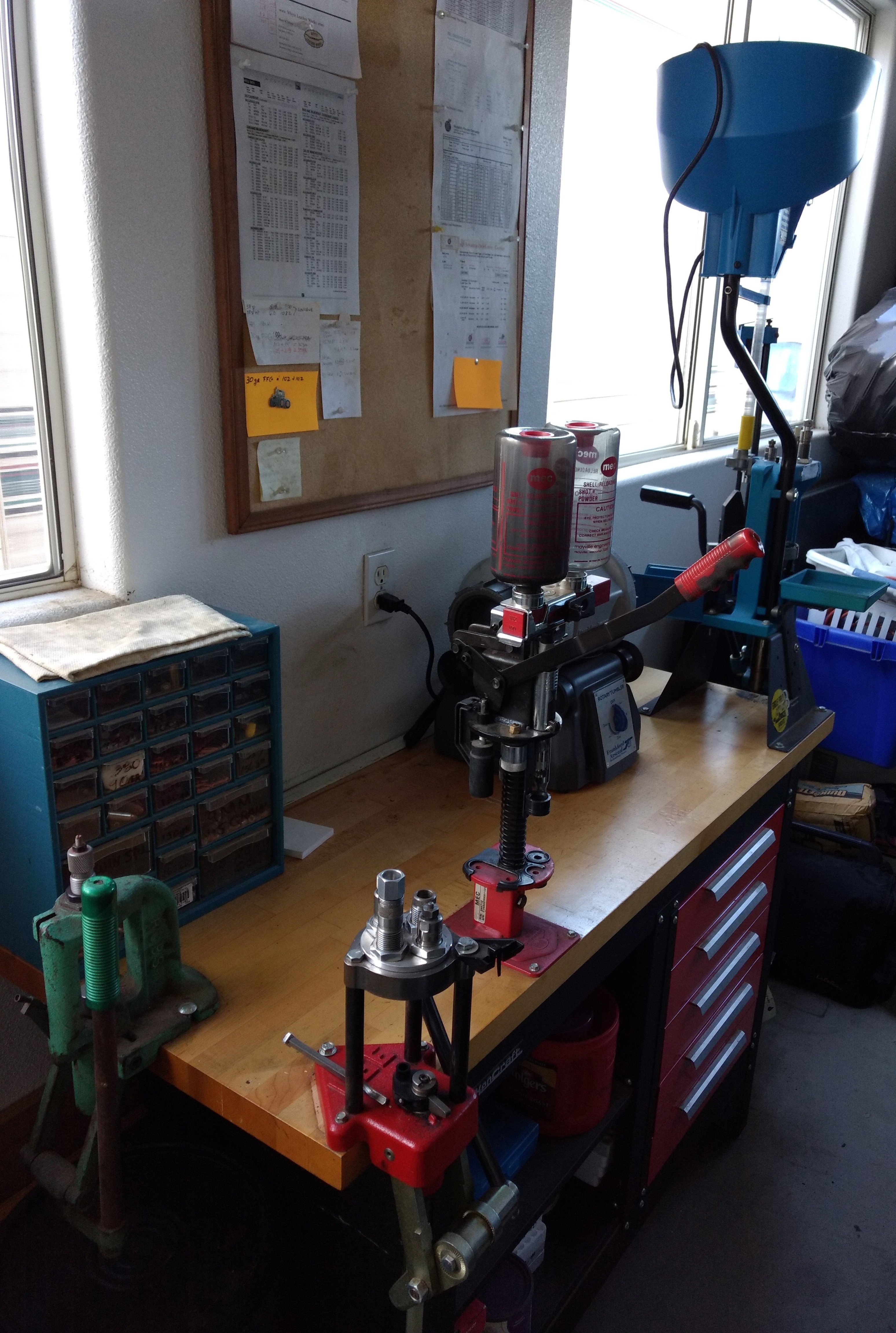

Red Eye Jim Posted June 14, 2018 Posted June 14, 2018 I started typing up a long list of my own personal history with reloading, but it boils down to this: I started in '84 in highschool on an RCBS single to do 30-30 for hunting season. Learned to make very accurate ammo rather quickly from a great mentor who had a great system. Had a used Horniday 4 stage in the 90's but never used it because I was afraid I'd mess up with it as I no longer had a mentor to watch over my sholder. Got interested in other things and stopped shooting for a while. When I started this game last year, it was clear I was going to need to reload, but I was out of practice, however my brother uses a Dillon 450 and loved it. I thought about getting a Square Deal as I only plan on reloading straight wall ammo, but got a 550C because I may start loading .223 at some point. The video that came with the press and the call I made when I had trouble configuring powder drop correctly set my mind at total ease. And has put my wife at ease as well. My advice to new re-loaders: Get a mentor. Talk to the guys in your home club and find someone willing to show you the ropes. If you can afford it, get a Dillon. Get the one you can afford. The fact that there is a number you call to talk to someone who knows the press intimately makes it worth it. Get the low primer warning alarm. Once you get comfortable with the accuracy of the press and start getting yourself into the grove of loading, it will save you from yourself. (Nothing worse than getting in the groove and realizing 150 rounds in that you haven't loaded primers and the last 48 rounds you just ran have been lightly dumping powder all over and now will need to be pulled apart and done over.) Get a bullet puller and don't be afraid to use it if you think something is wrong. If you can afford it, get a conversion kit for every caliber and configuration you're going to load and lock them in. If you only want to use one powder throw, then get a precission measure throw for it. And my own personal preference, but you don't have to: De-prime your brass before cleaning. Personally I think a clean primer pocket solves potential issues before they can creep in. Use poly-coated bullets. I find I don't need to lube cases, and I have yet needed to clean my loading dies (But I'm only about 20K rounds through it at this point.) Get a case gauge and use it for every round. Not only does this help me identify rounds that might not feed well in my rifle, it forces me to slow down and inspect for other flaws I might otherwise miss.
