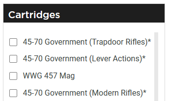

Edward R S Canby, SASS#59971 Posted May 13, 2024 Posted May 13, 2024 Some suitable loads can be found online. See Hodgdon's Reloading Data Center. There are loads listed for 45-70 trapdoors. Alliant also has Trapdoor loads (if you can find any of their powder). Alliant Powder - Reloader's Guide

Boggus Deal #64218 Posted May 15, 2024 Posted May 15, 2024 Dark Horse, there are PLENTY of smokeless trapdoor level loads available. Hodgdon Powder, Accurate Powder, and all powder manufacturers list them.
