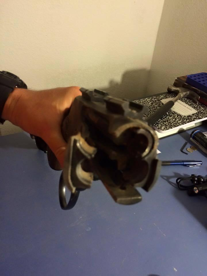

Buckshot Bob Posted March 1, 2023 Posted March 1, 2023 Copied from FB , since it’s a lever gun I think it applies here Randy Evans on 'reloading 101 Anybody ever wondered what an exploding 45-70 marlin guide gun will do to a person's hand. All my measurements and charges were correct. But I forget forgot to crimp the bullet. This caused the bullet to seat deeper and deeper with every shot which ultimately seated the bullet to a point were the pressures were dangerously high causing the pressure to build before the bullet could leave the barrel.
Pat Riot Posted March 1, 2023 Posted March 1, 2023 Owwwwwwe! Looks like he knows what went wrong. That’s good. It’s too bad he didn’t catch this before that disaster.
Buckshot Bob Posted March 1, 2023 Author Posted March 1, 2023 3 minutes ago, Pat Riot, SASS #13748 said: Owwwwwwe! Looks like he knows what went wrong. That’s good. It’s too bad he didn’t catch this before that disaster. I at least attempt to learn from other people’s pain, 45/70 isn’t generally a cartridge people associate with high pressure. There’s lots of ways to screw up reloading. This is just one of the many. Looks like he’s going to be ok , not missing any fingers
Pat Riot Posted March 1, 2023 Posted March 1, 2023 1 minute ago, Buckshot Bob said: I at least attempt to learn from other people’s pain, 45/70 isn’t generally a cartridge people associate with high pressure. There’s lots of ways to screw up reloading. This is just one of the many. Looks like he’s going to be ok , not missing any fingers I agree. I am a real stickler for double checking everything when reloading and I am guilty of probably more crimp than is necessary.
Buckshot Bob Posted March 1, 2023 Author Posted March 1, 2023 Just now, Pat Riot, SASS #13748 said: I agree. I am a real stickler for double checking everything when reloading and I am guilty of probably more crimp than is necessary. I’m pretty attentive when I reload , but every time I see something like this I think, there before the grace of God go I . Everyone has a lapse in awareness occasionally and some just simply don’t know any better.

Badlands Bob #61228 Posted March 1, 2023 Posted March 1, 2023 I'd be surprised if he has full use of his left thumb after this. That's a lot of damage.

Forty Rod SASS 3935 Posted March 2, 2023 Posted March 2, 2023 I remember when Undertaker double loaded a 12" 1st gen SAA .45Colt. He said he was loading 3.6 grains of Unique and went to answer the phone, came back and added 3.6 more. I think he salvaged the grips. The rest hung above the cash register at The Flintlock at Hobby City.
Smokin Gator SASS #29736 Posted March 2, 2023 Posted March 2, 2023 8 hours ago, Forty Rod SASS 3935 said: I remember when Undertaker double loaded a 12" 1st gen SAA .45Colt. He said he was loading 3.6 grains of Unique and went to answer the phone, came back and added 3.6 more. I think he salvaged the grips. The rest hung above the cash register at The Flintlock at Hobby City. Was that of pre smokeless powder vintage? Otherwise shouldn't be a problem.
