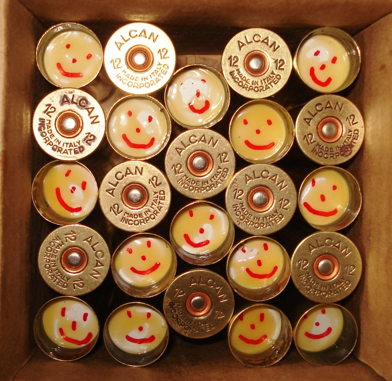

Abilene, SASS # 27489 Posted February 10, 2023 Posted February 10, 2023 Lefty, as Pettifogger mentioned, the 157 primers are too small for modern shotshells. However, they are what is needed for the Alcan brass hulls. Those are great brass hulls, thicker than Magtech/Winchester/Rem-UMC but thinner than Rocky Mountain Cartridge. I have had people give me their old 157 primers. So if you know anyone who loads Alcans, they will be happy to have them. Also, you might keep an eye out at estate sales, or check with any long-time gunstores that might have regular non-brass Alcan hulls in storage somewhere. I don't know if those were plastic or paper. I think that in an Apocalypse situation people might try to shim them with thin paper to sub for 209's (I'm NOT suggesting that!).
